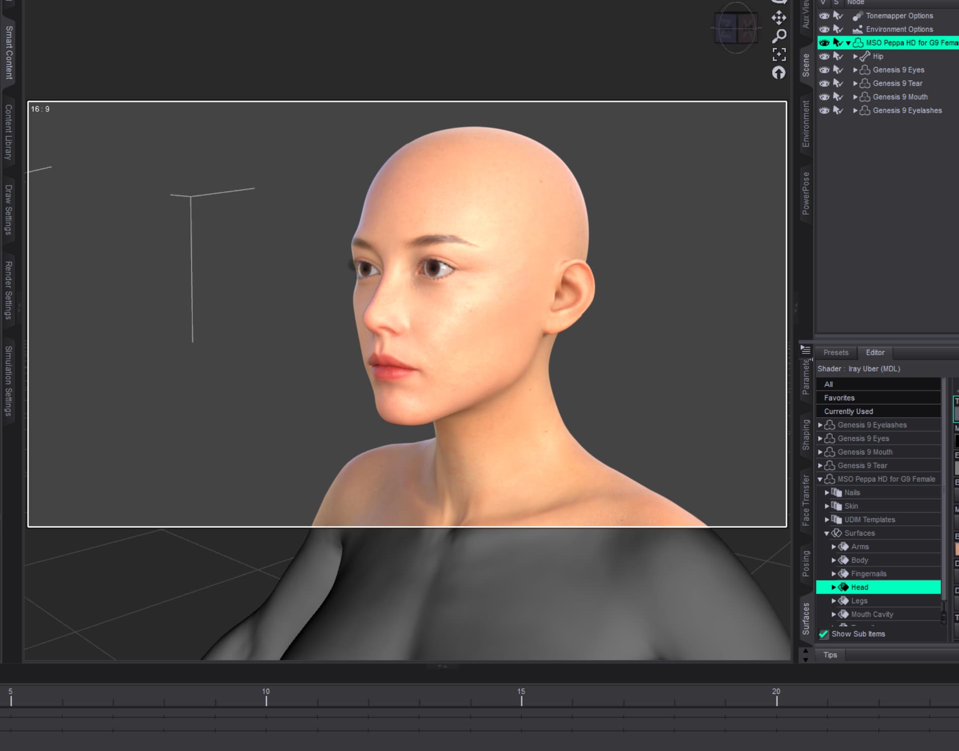

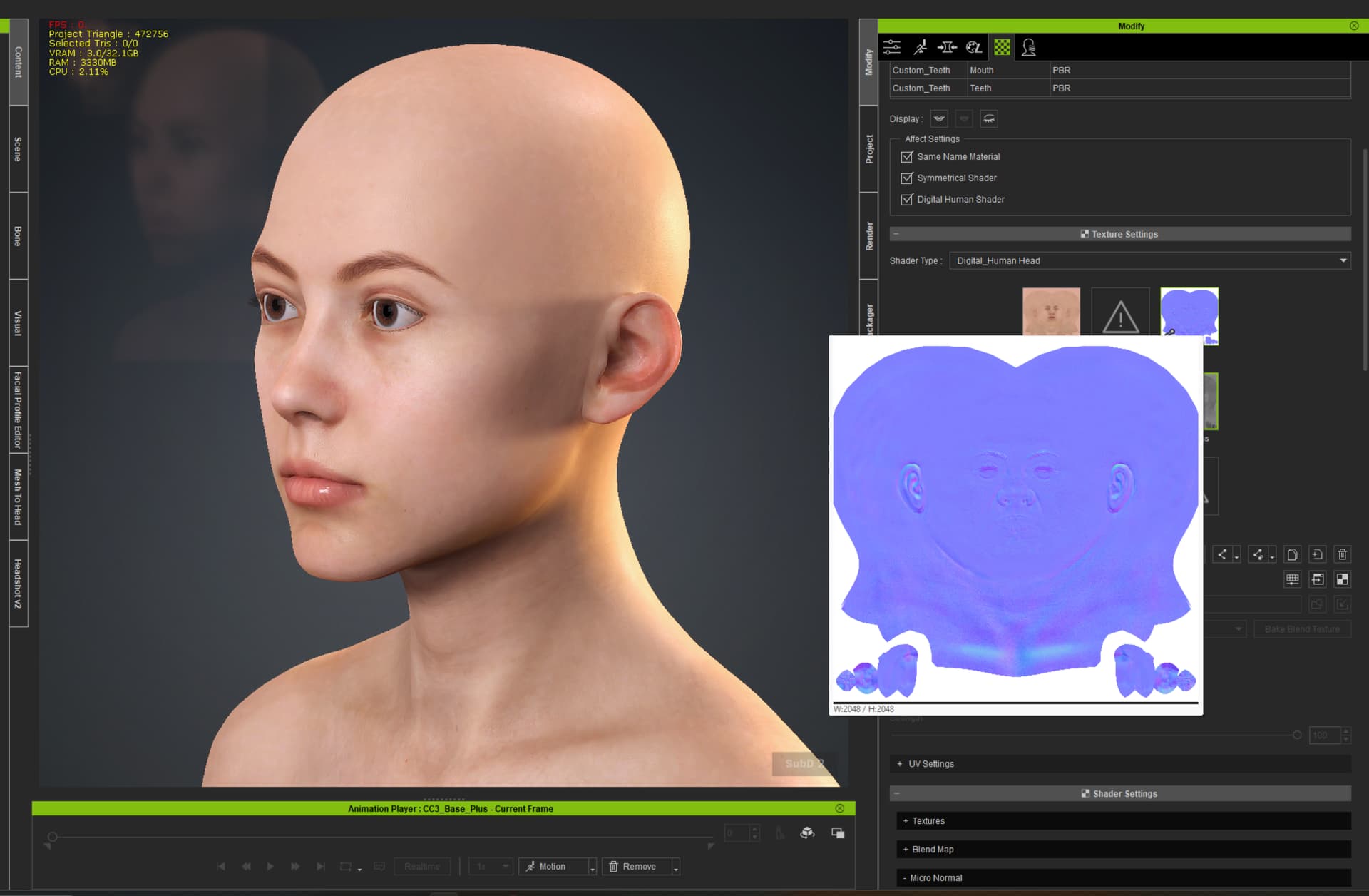

I followed along with the video tutorial that Wilson showcased above. I get the same error that amckenzie got in their attempt, but I just clicked okay and everything seemed to port in after that hiccup. I can confirm that setting everything that says "Genesis’ to subD 2 prior to exporting the obj is fine. However, make sure that the scale in the OBJ export window is set to 100%. It’s in the video but it’s hard to see as it flashes on the screen for only a second. Make sure you freeze the video to copy over all the settings for FBX and OBJ export. My OBJ export settings had defaulted to 2% when exporting and when running the transformer tool gave me a result that was worse than the horror movie The Fly. Still, the results are not exact and it seems the transformer maxes out at 2k texture resolution even if 4k is selected and the source textures are 4k originally:
