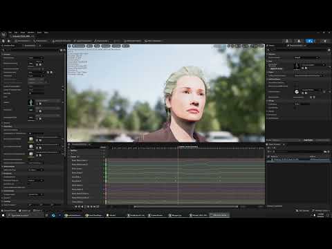

This is the first time I’ve ever encountered this issue where in iclone the hair as it’s always been I just drag and drop it on my character and it follows perfectly but for some reason in Unreal engine there’s some lag between the hair and the character’s head and no matter what hair I use including the ones I’ve purchased can I get this to align for some reason. Any ideas?
Are you using UE5.5? This might be an unexpected issue. Please submit a ticket to Reallusion Support for further investigation: Reallusion Technical Support
5.4! Also, I appeared to solve it but don’t know if I actually fixed anything, but turning off the physics on the hair in CC4, then passing it over to Iclone and then making sure the physics is off there appeared to do the trick, but I still found that odd and don’t think its intended to work that way.
