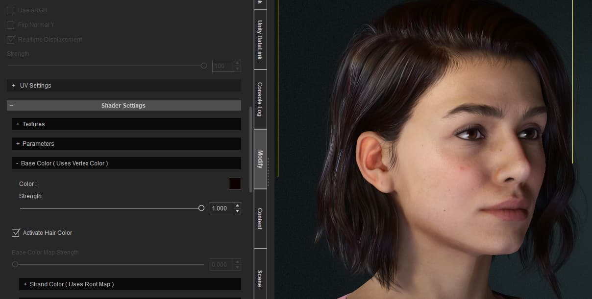

The vertex colours are a mask, Black → White = Vertex Colour → Texture Colour, which allow you to individualize each hair card’s shading even they share the same UV’s.

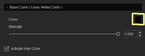

i.e. This shader setting in the Hair shader:
Which defaults to a dark brownish black.
So if your vertex colours on the mesh are all black, this settings overrides the texture colours.

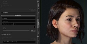

e.g. if we set all of Camila’s hair vertex colours to black, it looks like this no matter what diffuse textures are used:

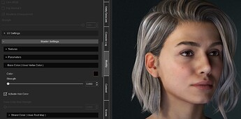

So either, set all your vertex colours to white in Blender, or set the base colour strength to zero in the hair shader in CC5:
