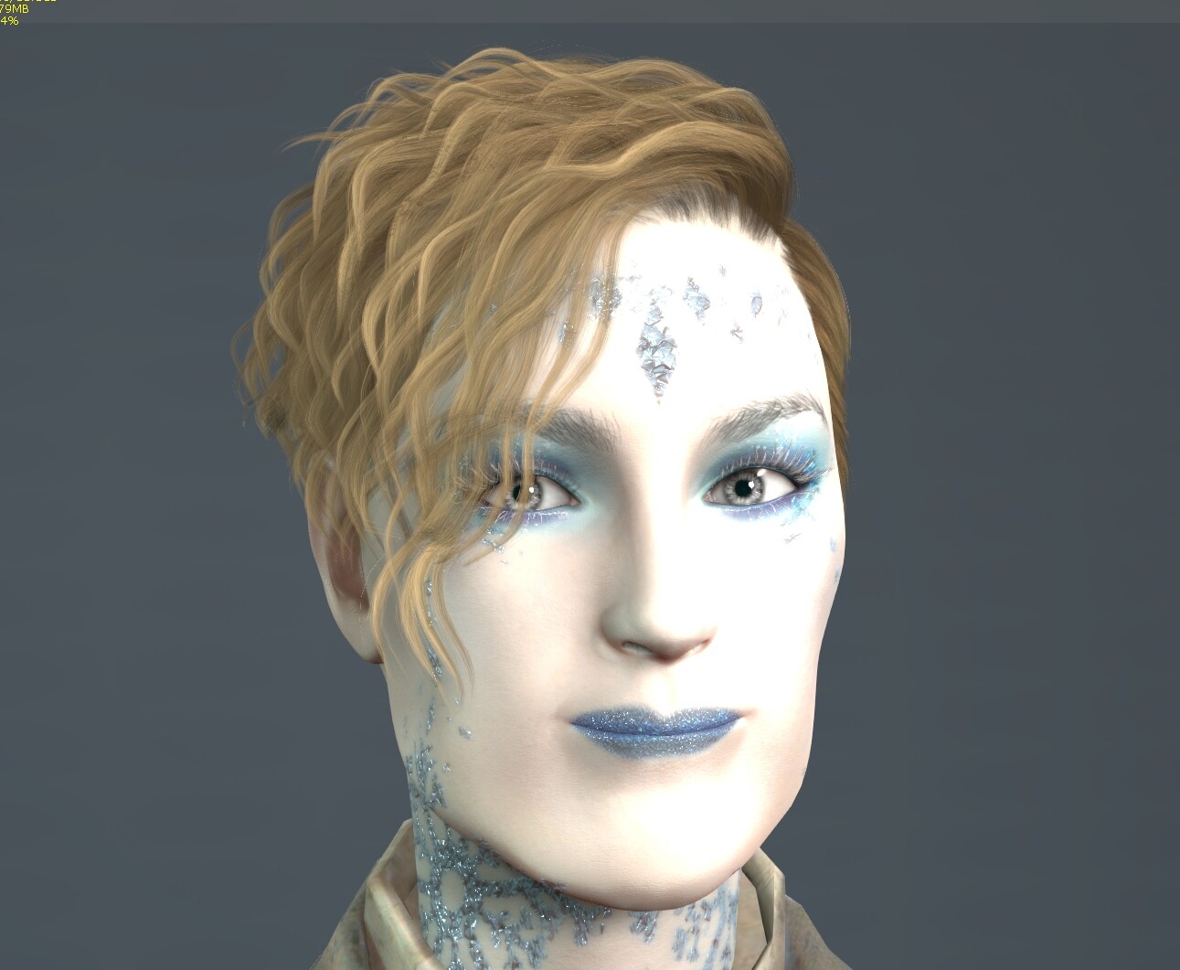

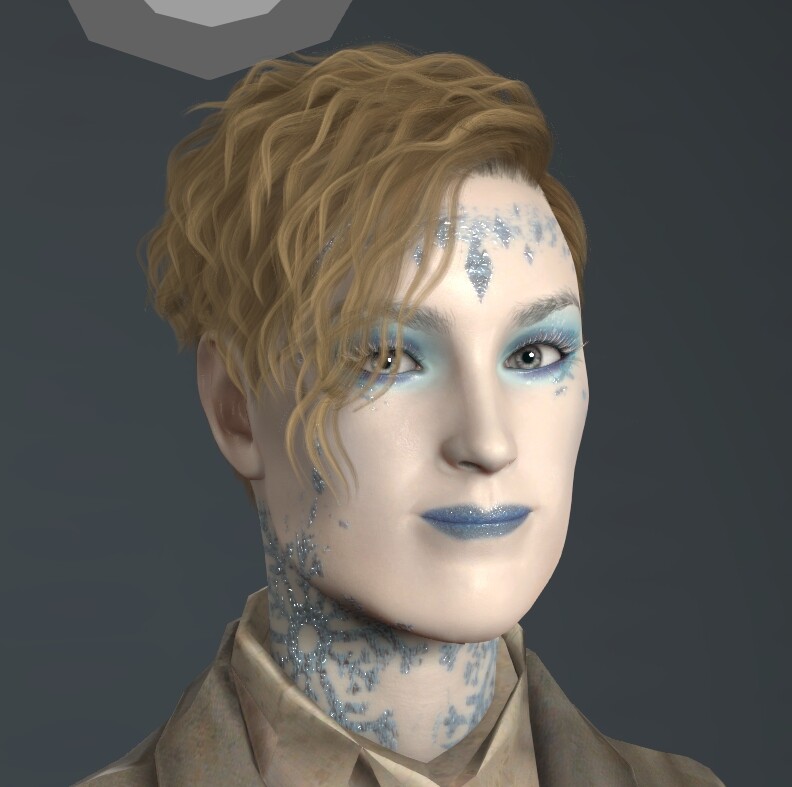

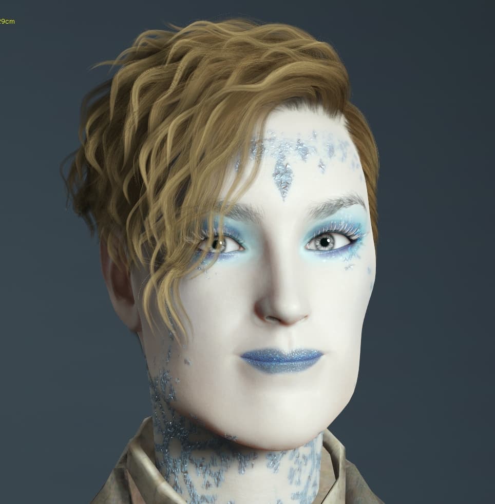

Something must be wrong here but cant find out whyt. I send this char (send all) to iclone and it looks really bad. Can someone explain this to me ? I compared all program settings and they seem to be the same. in Iclone everything is way too bright.
CC Scene
IC Scene

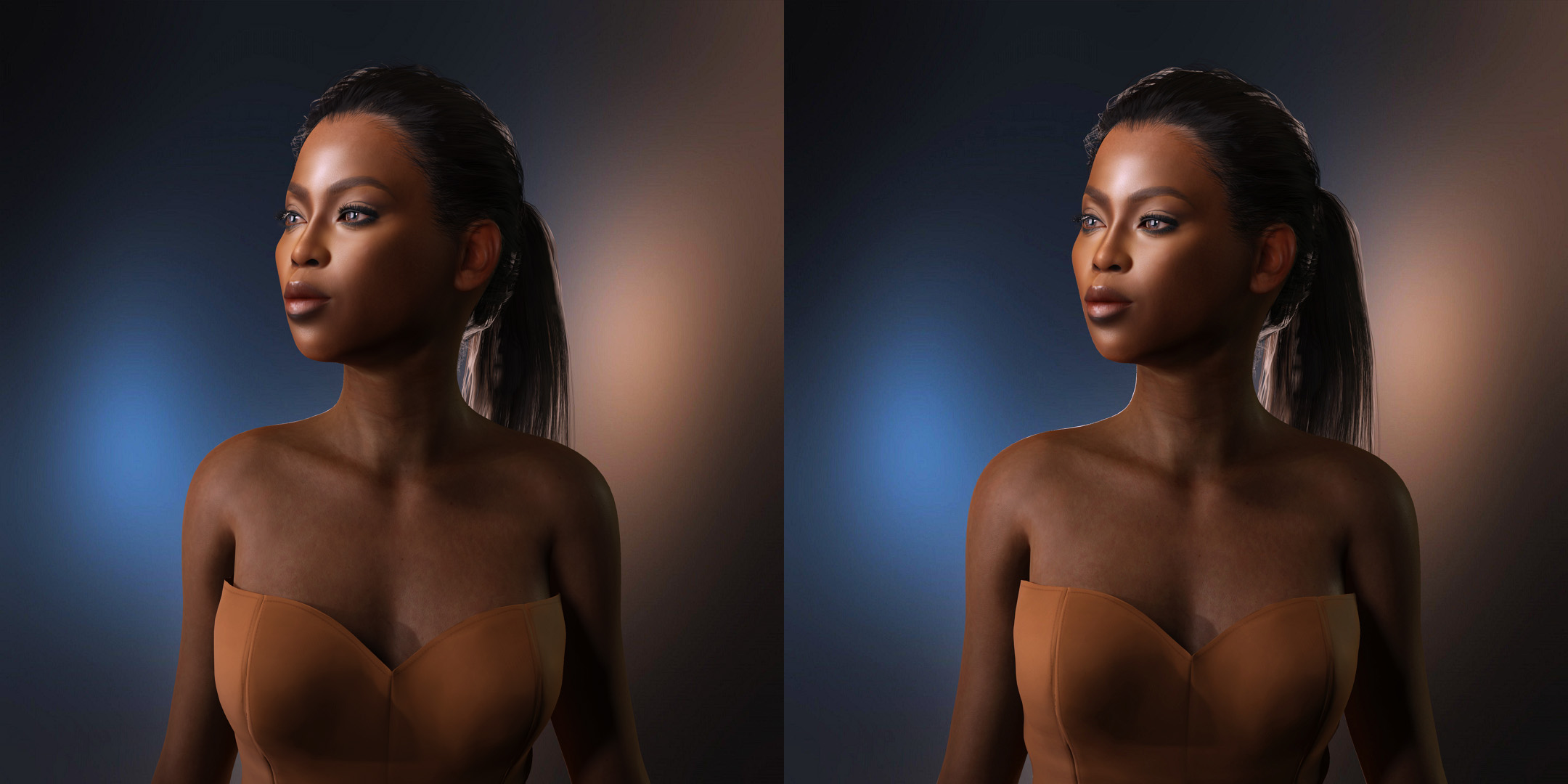

iClone/CC renders with Light Room transfer (only camera take is different)
