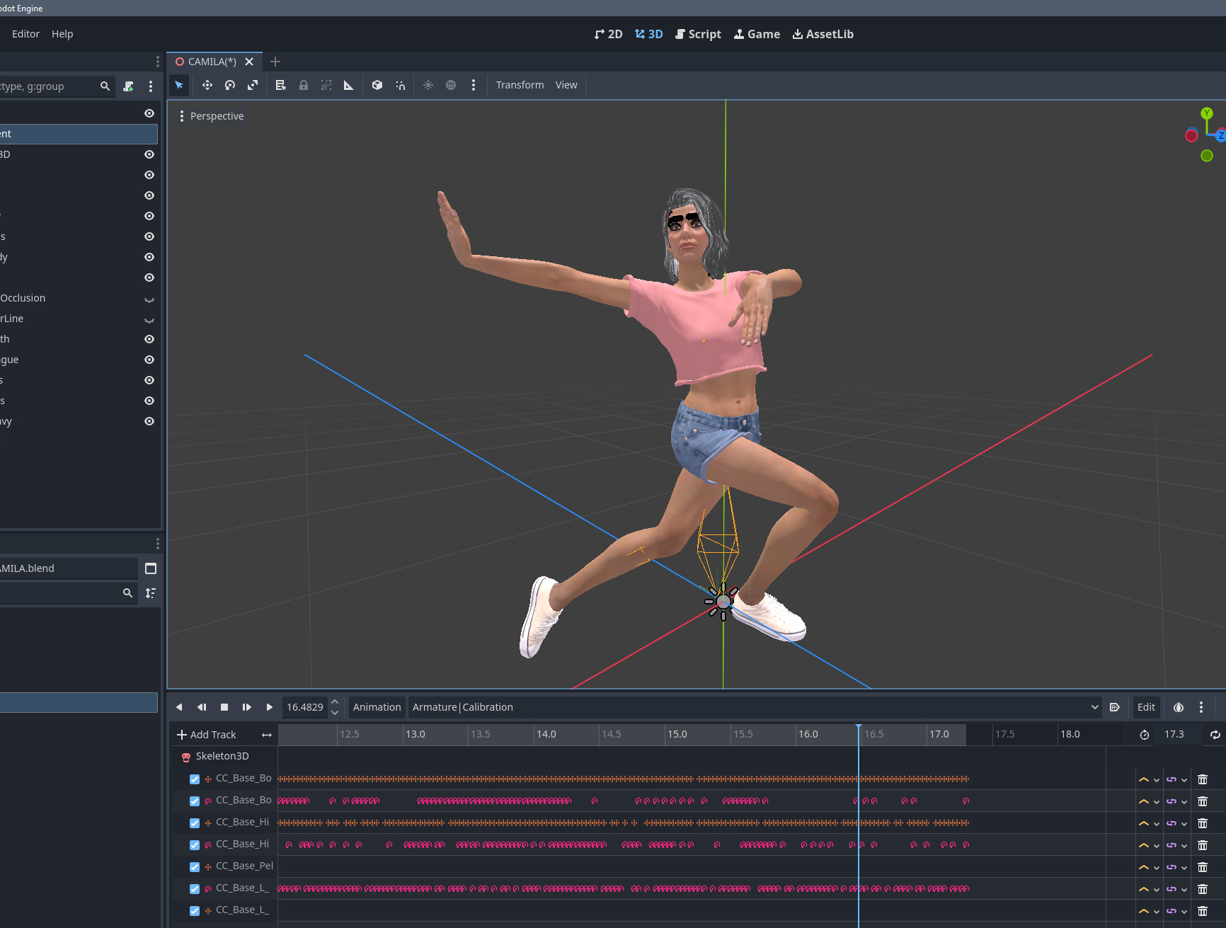

Thank you for your good advice all. My use case is importing animation files from iClone and using those.

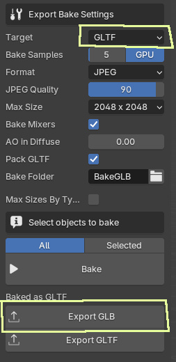

Yes, it bakes all the texture channels Godot supports, but it’s really for custom material setups. I read somewhere that Godot is supposed to match the texture names with the materials and set them up automatically if they are bundled with the model file, but it doesn’t.
What does work is GLB:
Once baked as GLTF the option to export as GLB becomes available, this packs everything into a single .glb file: model, materials, textures and animation, and Godot sets it all up correctly.
You will likely need to extract the hair materials and find a better hair shader for them as the default transparencies aren’t very good for hair.
