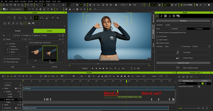

Hello. I’m trying to better understand gesture tracks. Since they are outside of the motion layer editing, I’m not figuring out how to set weight keyframes. Gestures clips have a blend in range but not a blend out one.
I am trying to fix motion capture clips that have fingers data with few artifacts in some ranges. I built a gesture library to adjust incorrect finger orientation, and I thought I would be able to blend over or even override certain moments, but the applied gesture clip remains after the clip end until another gesture is placed in track.
Is it possible to blend gesture out in order to get back to original finger mocap after placing gestrues in a specific range?

Hi. I am aware of the Gesture Plugin and in fact I am using it. But it has a different worflow, since it is applied to the main motion layer. Furthermore, it requires additional steps, such as breaking the clip in the desired range and offseting the next clip fragment at least a frame to avoid it being deleted.
It would make much more sense if it was applied to the gesture track and being able to blend, enable or disable influence over the main motion.
I am still looking for a way to blend out the gesture track´s clips.
