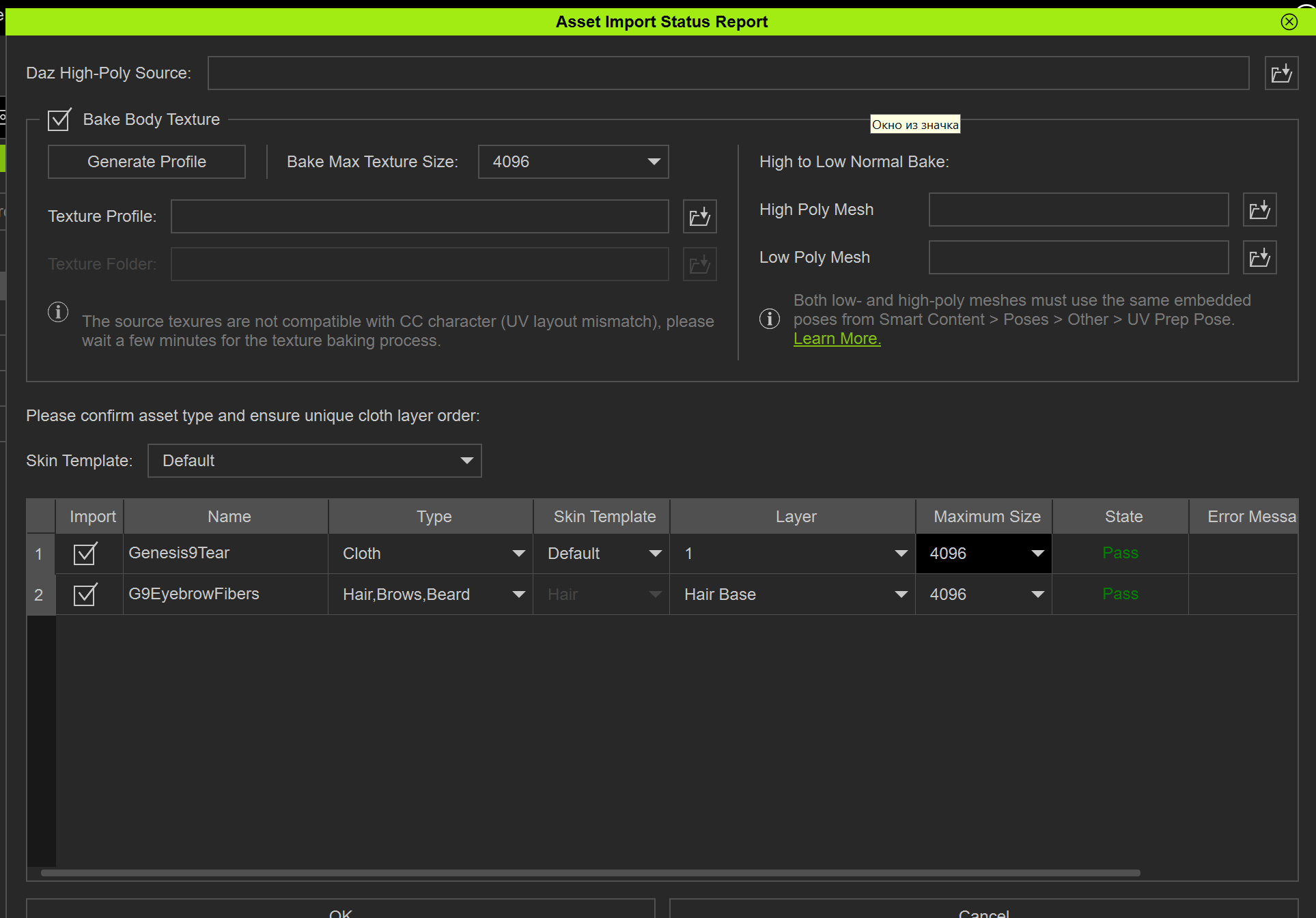

Hi, I tryied to import Genesis 9 figure to CC5.06 and it has new options
High to Low Normal Bake:
High Poly Mesh - field
Low Poly Mesh - field
As early I filled up Daz High-Poly Source with an obj file with Subdivision level 2 also I fill up two new fields with obj files Subdivision level 2, 1. After press OK I got error: Character Creator transformer “This high-poly source does not meet the requirements.” and etc… Can anybody provide me instruction about new features?

I have the exact same problem following this recent tutorial:
I tried to match all the options shown in the video, but i still get the “does not meet the requirements” error message.
Any solution yet ?

Exporting the Mira (Gen9) character from Daz to CC5 following the workflow explained in the tutorial video.
Everything works well, except the use of the obj file, with the exact same message as you: “This high-poly source does not meet the requirements.”
I did not try yet with another DAZ character so i still don’t know if it’s a general problem or only a problem with the Mira figure.
