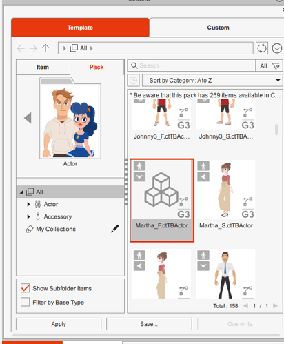

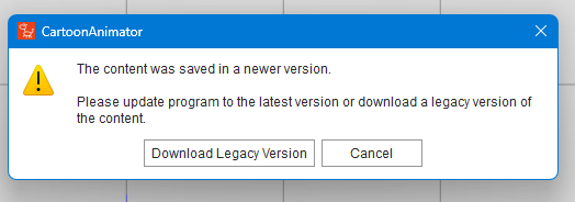

Addition: Further to my original post. I have discovered I cannot load some actor files. It says content was saved in newer version (I am up to date) please update program or download legacy version.

I also found that some Characters do not carry over.

Are you using an earlier build of Cartoon Animator and not the latest version which is 5.32?
I ask because that error message means the character was saved or is from a newer version of Cartoon Animator than the version currently being used.
For example, content from CTA5 can’t be used in CTA4. Content saved in CTA 5.3 can’t be used in CTA 5.2 and so on.

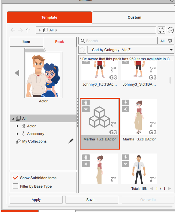

I used Athlete Tim for the bone structure. I tried loading this individual in CA5 (I tried others as well) but I got the same message. It would seem some of the characters have not been transferred properly. The image on those I tried appeared a little out of focus.
