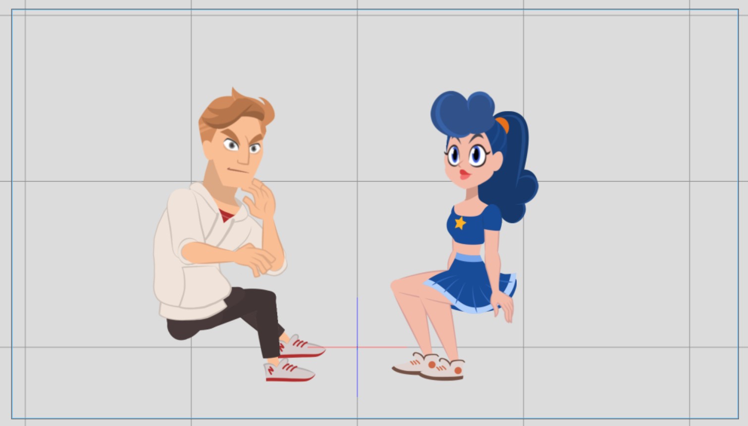

All of the default G3 360 characters that come with CTA5 feature a front and side angle. There are also G3 360 dummies provided that with 5 different angles to help creating your own characters.
So based on your requirements, everything you want to do is possible using the G3 360 characters in a side angle pose as can be seen in the simple setup below (without props).
