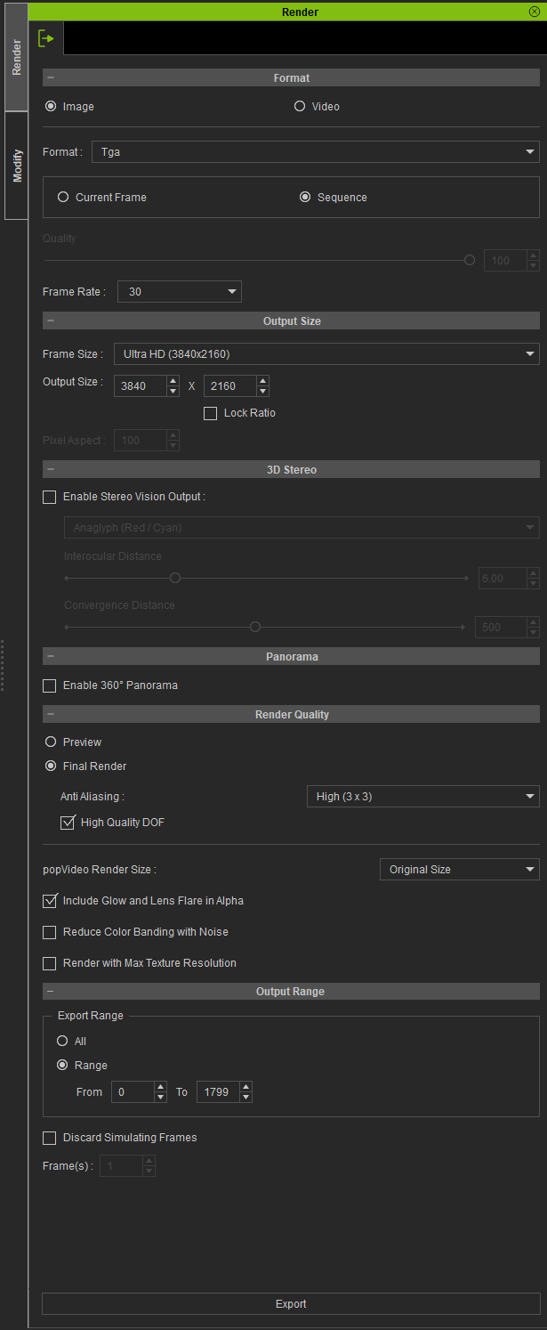

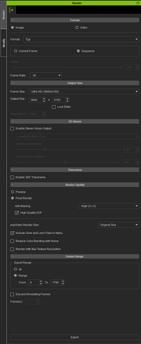

That’s good, but still there’s quality difference between render and
What I do to render sequence image is to select this settings in the render window

Thank you for your response!
I understand that pressing the Export button with UI allows rendering as a Sequence.
However, what I’m trying to achieve is to render it using PythonCode .
As a test, I saved the Scene with your settings and ran RLPy.RGlobal.RenderVideo(), but it still renders based on the Video Settings configured in the Scene. (crying)

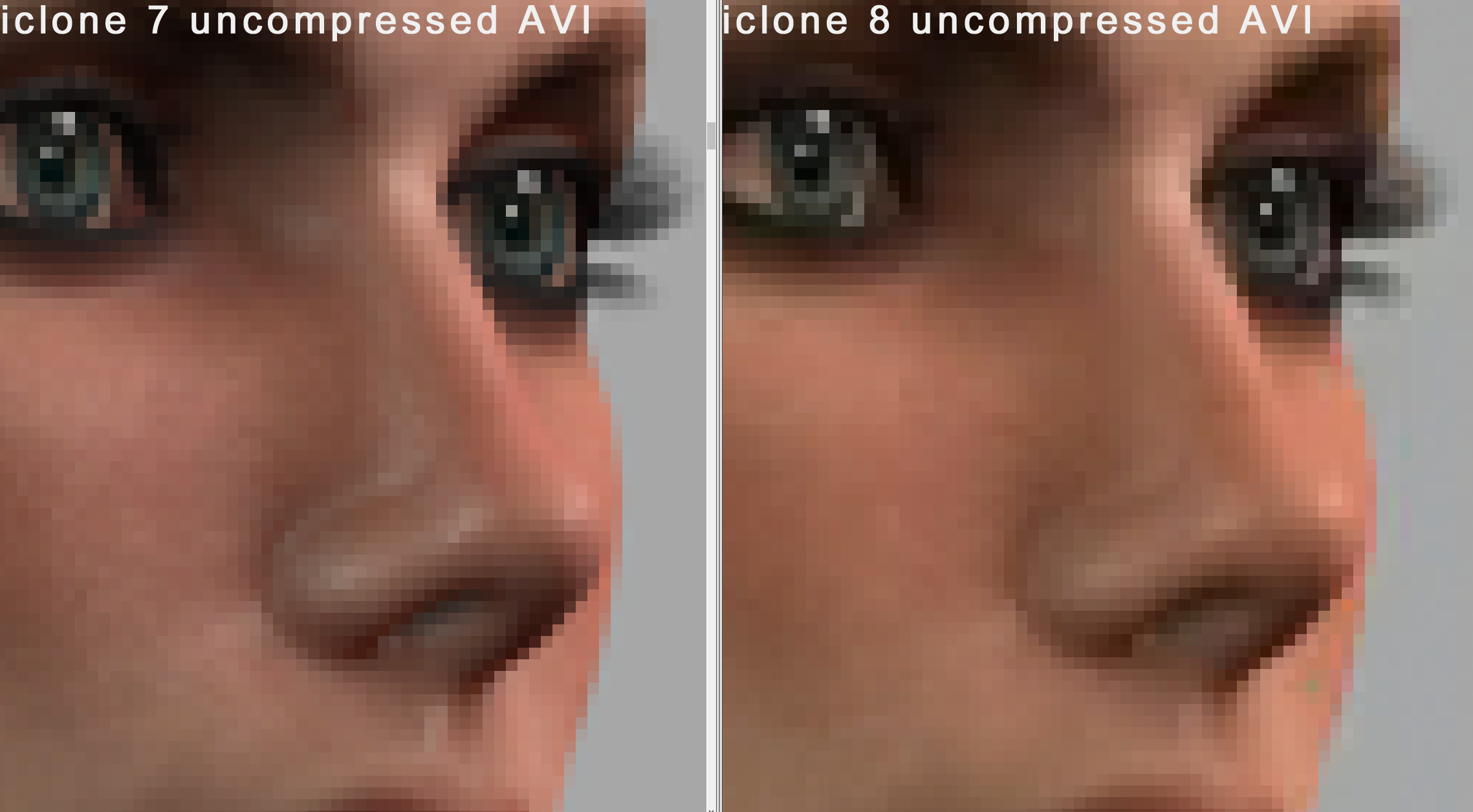

I have to retrieve my second statement!
iClone 8 apparently has this ugly bug where it does NOT render AVI uncompressed any longer.
I rarely render to AVI (always output to an image sequence for important renders).
So I just glanced at the size of the 60 frames render to uncompressed AVI produced by iClone 8 and was shocked to see that it was only 400Kb.
I then started a new project in iClone 7 and opened the same project in iClone 8. Rendered both 60 frames to uncompressed AVI.
iClone 7 render was 1.4 Gb in size
iClone 8 render - the same 400 Kb
Maybe 1.4 Gb is over the board, but 400 Kb is certainly not enough for 60 frames to accommodate for quality match with PNG image sequence.
Under 1800% zoom there were visible signs of smudged and compressed frames in iClone 8 AVI render, while iClone 7 AVI render matched almost perfectly the PNG sequence.
So yes, as I said it’s a bug in iClone 8!
I wish someone to confirm it too and it’s not just an issue with my iClone 8 install.
I guess you can see the difference:
