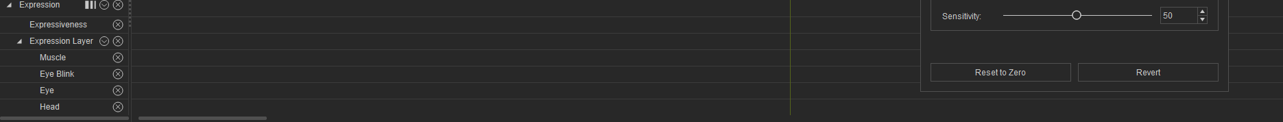

Thanks for your reply, I have checked that track and there are no keyframes in there. I’m on the latest release, perhaps a bug?
I shut down and tried again, but still no keyframes. When i scrub over the timeline to the place where there should be a keyframe, the face key editor show ‘revert’. So its recognising that something is there… perhaps i have to activate another setting or something??

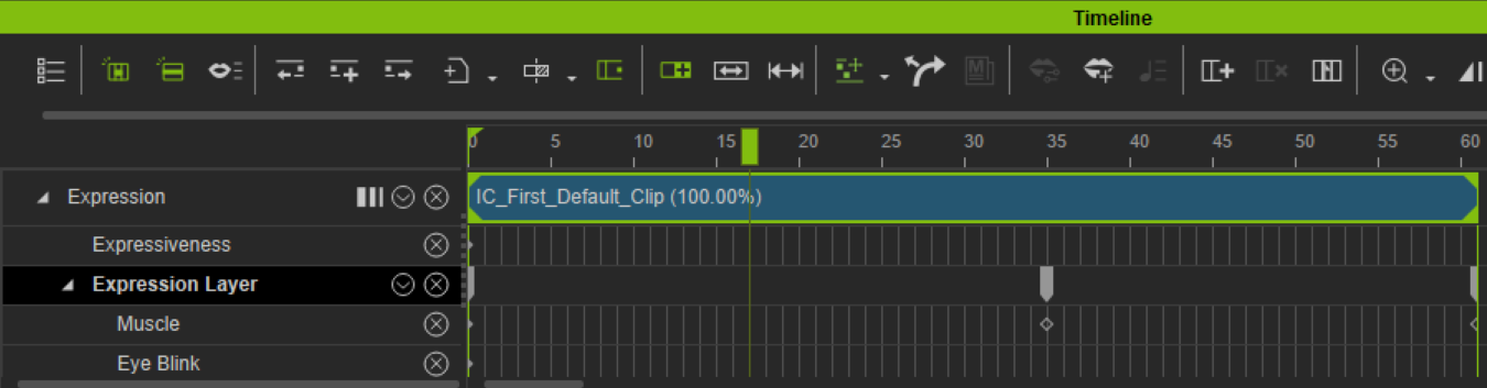

With the default Camila character using the Face Key Editor the timeline should show like below when muscle keys were set at frame 35 and 61.
FIX:
On the left side of the Timeline(down the bottom), find your character’s name
Slightly to the right side of his name, there should be a Down Arrow
Click this Down Arrow which will open up which tracks are to be displayed, and tick the box next to Expression
Now your Timeline will expand downwards, so scroll down to find the Expression tracks
