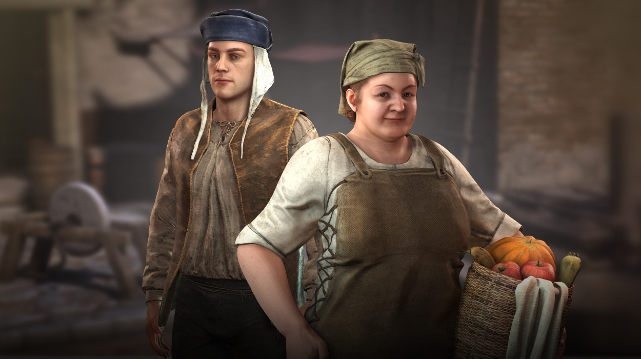

New to Character Creator and trying to get clothing to work right. Currently using “Medieval Peasant”.
I figure there are probably some settings I’m missing to fix these issues.

Are the apron and the trousers from one of the RL stores? If so, can you provide a link to these assets in the stores? I may have them and could try this myself.
If these assets are not “native” to iClone/CC, that may also be part of the problem. Some creators of RL assets try to give the buyer soft-cloth settings that (more or less) work out of the box, other asset creators don’t bother with soft-cloth physics at all, especially on things like trousers, so it is up to the buyer to experiment.

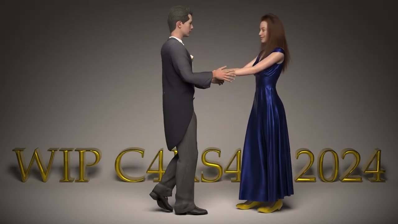

Things can get a little tricky if I try to attach different simulated “bodies” to one another. You may recall the following simulation I did some time ago where the rose (as a soft body) is attached to the fully dynamic coat (cloth) of the male character.
Yes, I remember… came out nicely. And yes, rigid to cloth attachment is a pain and ever more pain baking it and exporting a whole thing as alembic.
Well, yes and no. I don’t need to bake it to Alembic for exporting (e.g. to iClone) since I don’t do that, but the external cache files for cloth simulation in C4D are Alembic files so I have to use them all the time. BTW: there is one Alembic for each object; I haven’t checked, but I would think that the rose and the jacket in this case are separate Alembic files.
Of course you don’t need to export alembic, but I do, as I work mostly in iClone :wink:, hence a dilemma with some specific setups in Blender (which differs from C4D).
