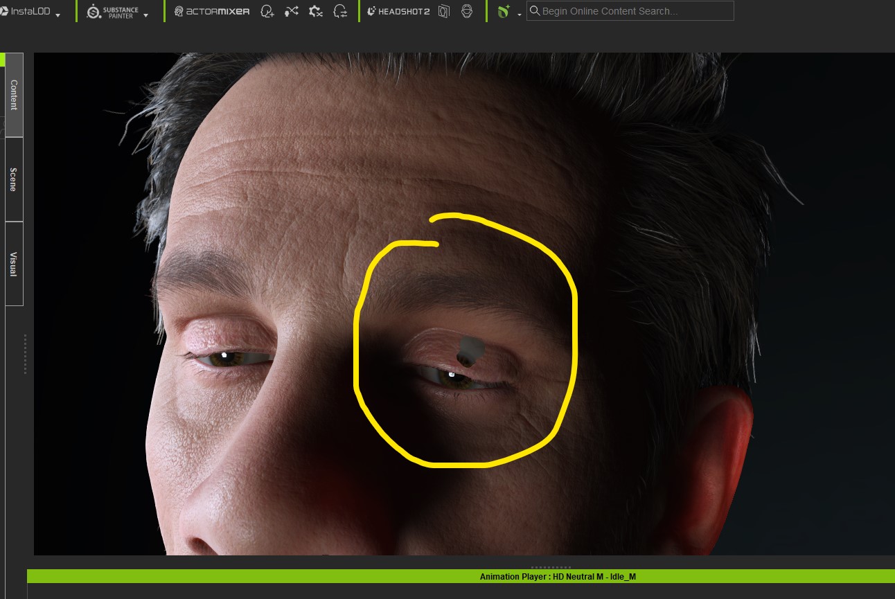

When he closes his eyes, he does it correctly.
But in tests, like Emote, the eye appears above the stationary one in some blinks.
Eye

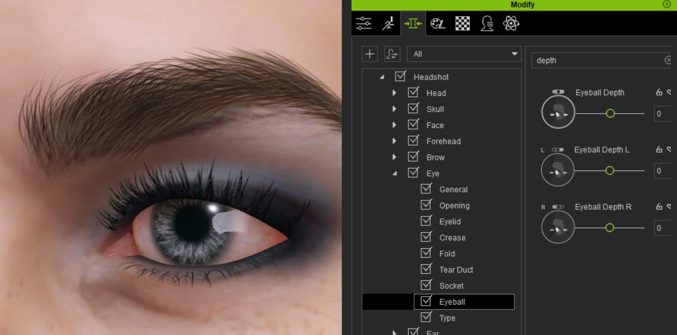

I have had that happen sometimes. I then move the eye backwards a bit with the Eyeball Depth morph:
What also sometimes works:
Move the eyeball forwards. Character Menu > Correct Eye Blink, with the eye ball forwards, then move the eyeball back to it’s original position.
This way the eye blink expression is pushed further out.
