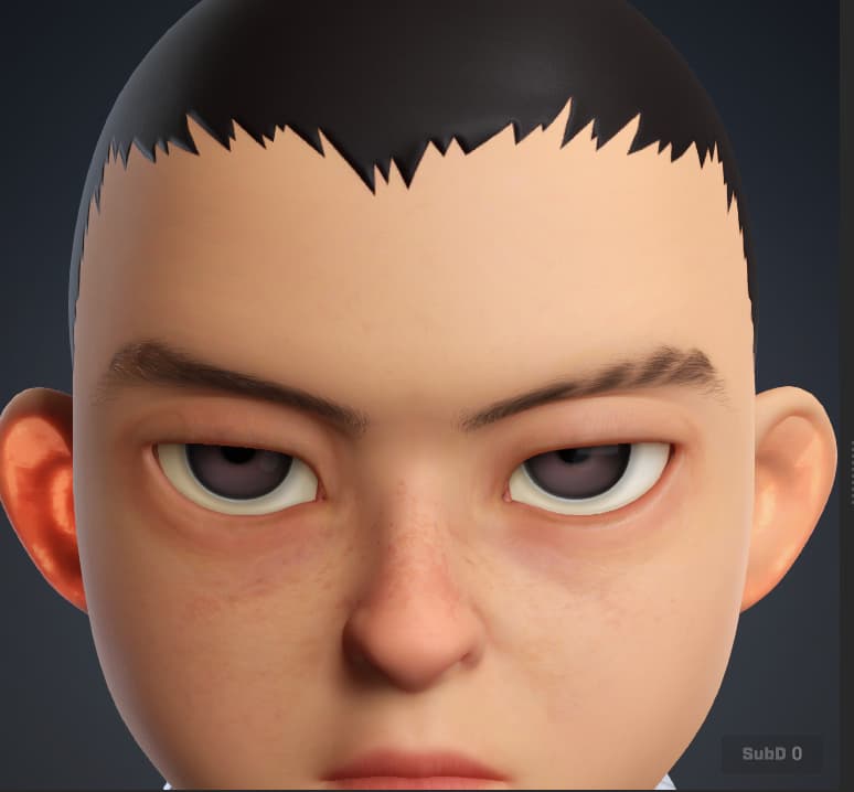

When I apply “real” eyebrows to a toon-textured character, the eyebrows have a kind of light halo around them. Is there a setting I’m missing to fix this issue?

On further testing, the issue seems to be the way the Toon texture is being applied: I wanted a more realistic shaped character with a toon skin texture, so I started with a CC3+ realistic character and applied a saved Toon texture (saved in the Custom tab) then applied the eyebrows, so maybe CC thinks the character is still the realistic base color and not the applied toon texture(?) I guess I should start with at Toon base rather than apply a toon texture later, since adding the realistic eyebrows to a Toon figure works fine.
