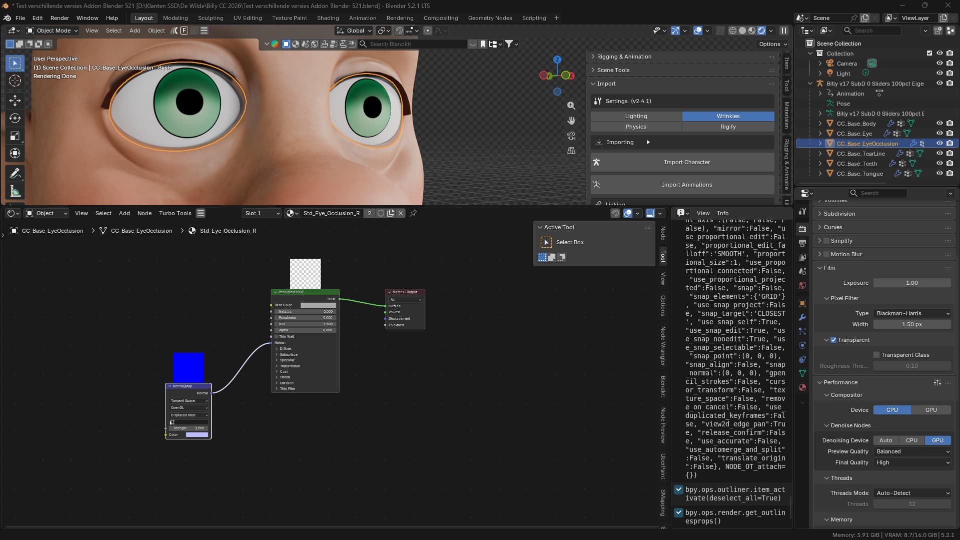

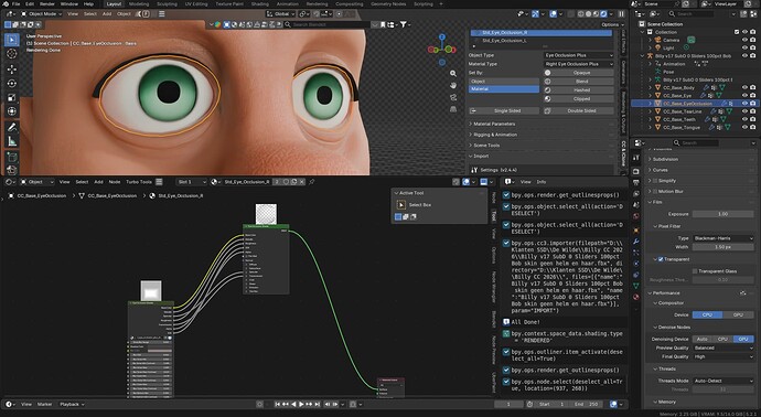

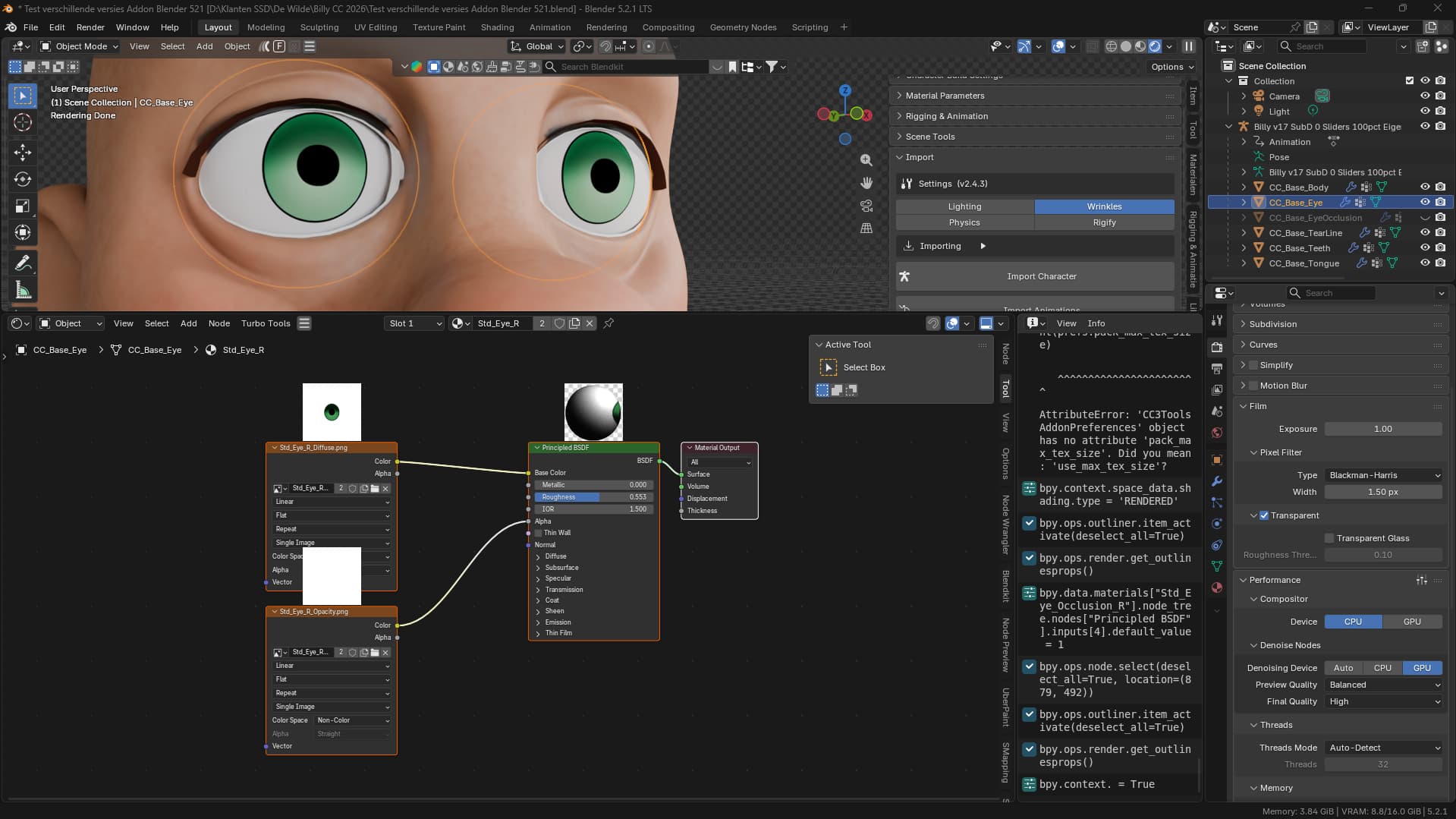

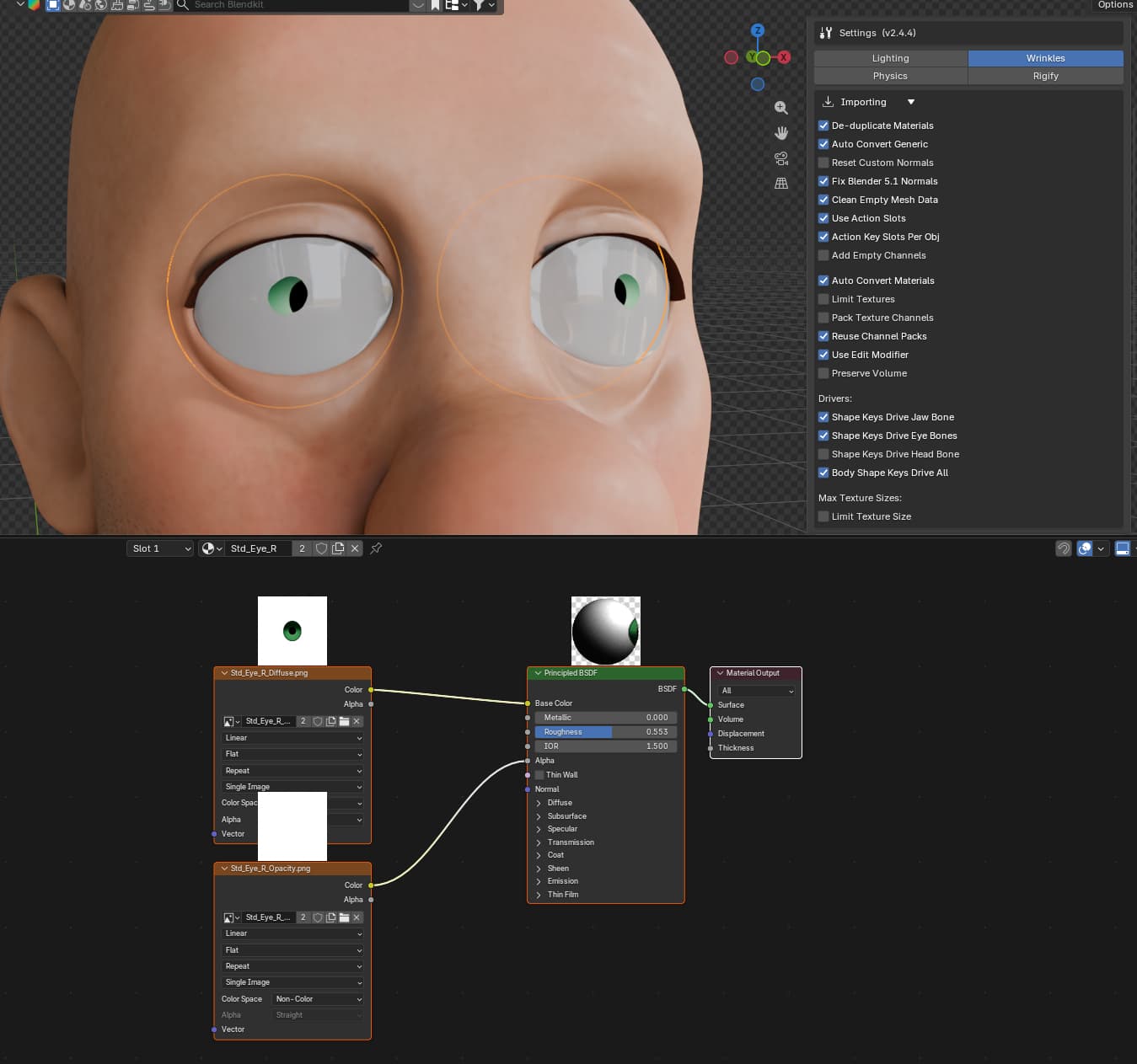

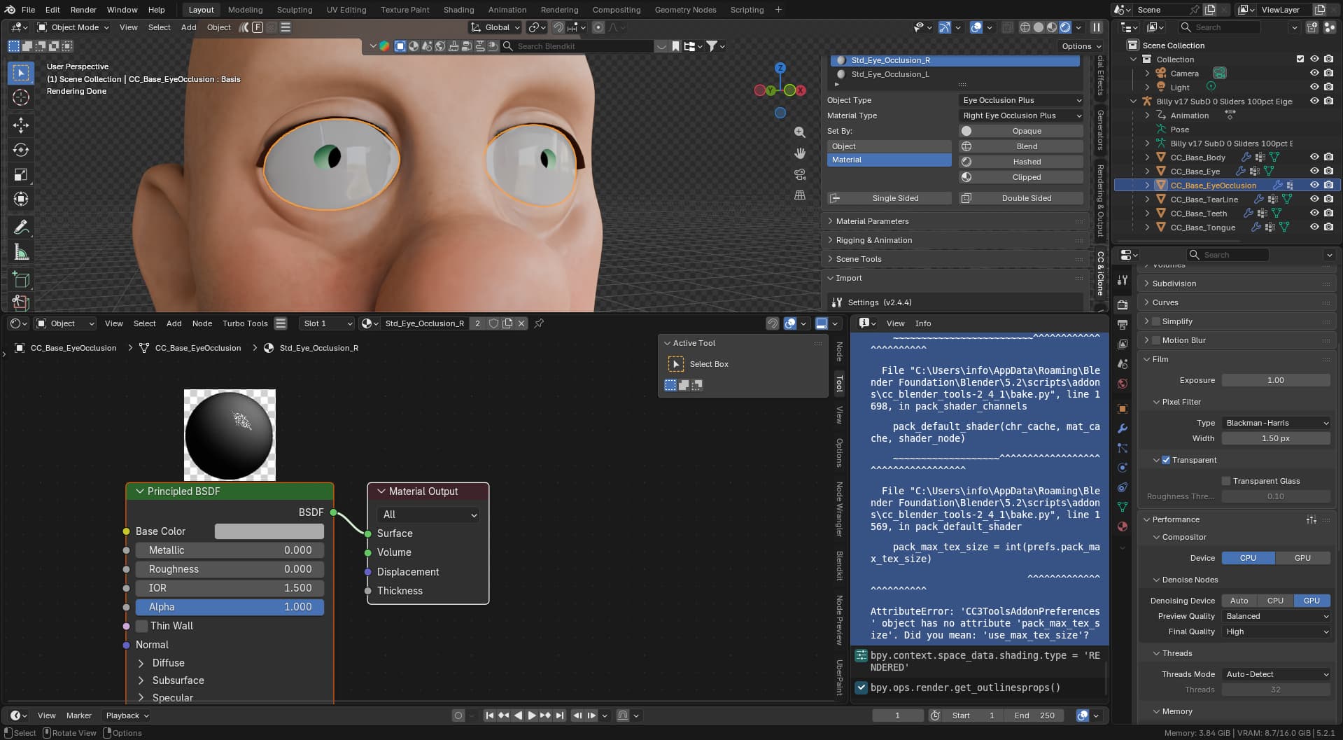

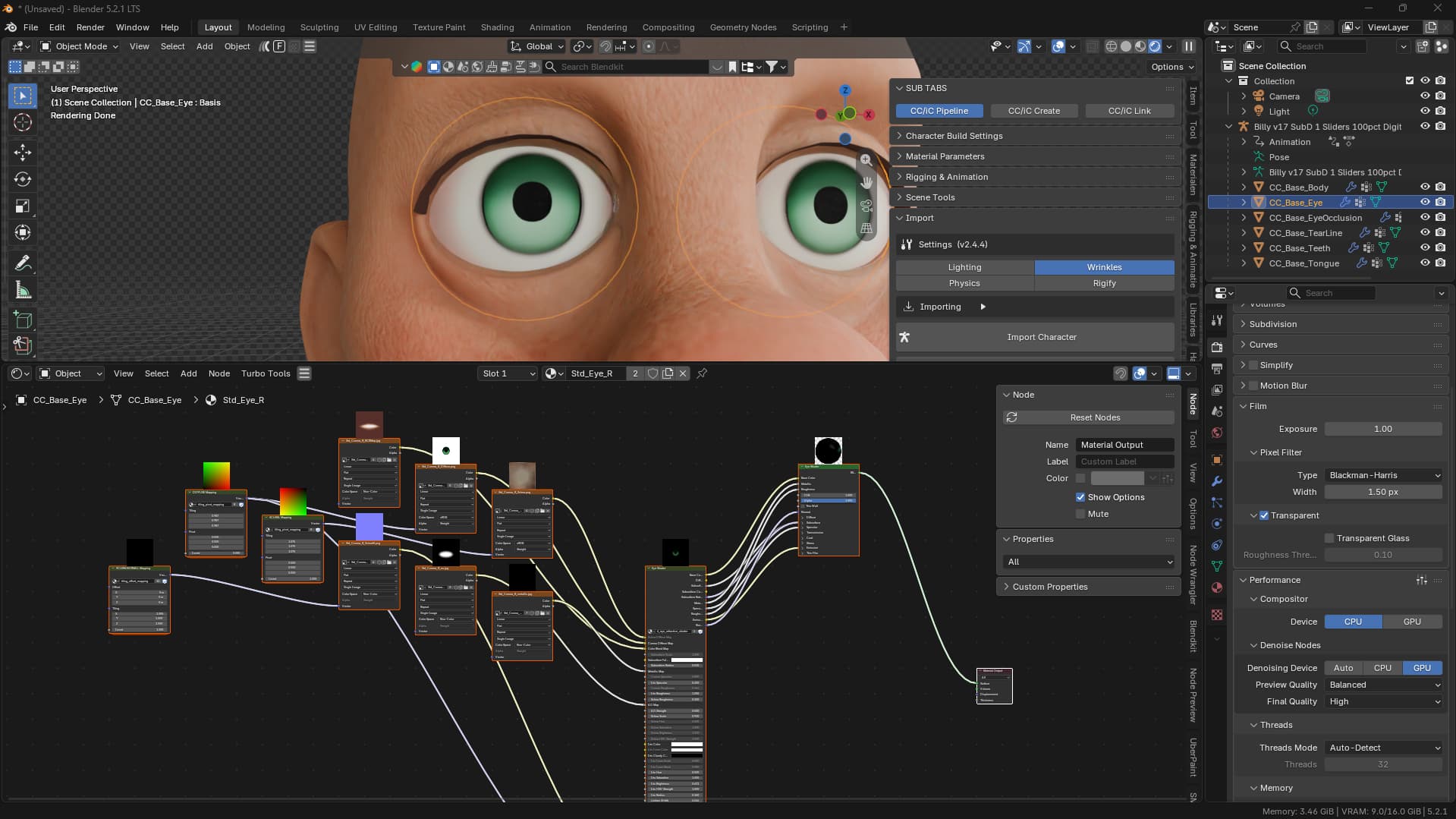

When I import a custom character in Blender 5.2, the materials of the eyes are messed up.
The Std_Eye_Occlusion_R and _L materials are missing nodes, and are not transparent
The Std_Eye_R and _L materials are missing nodes, which makes them appear flat
It seems to be only a problem when
  • I use my custom skin (just body and head. The eyes are the same in all examples)
  • In Blender 5.2.1
  • addon 2.4.4 installed
  • Both when I use DataLink or Export/Import FBX by hand.
When I throw a different skin on the character, the eyes are fine in Blender 5.2.1
But in Older Blenders, with the older vesions of the addon installed, my custom skin is not causing problems with the eyes.

Blender 5.2.1 With Addon 2.4.4. Custom skin on the character

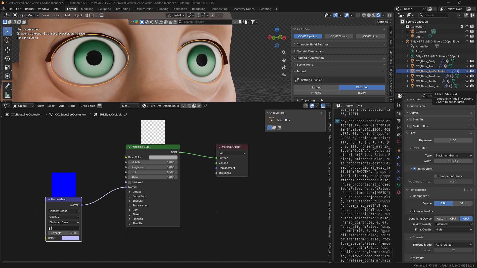

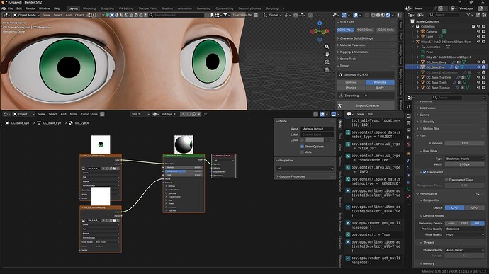

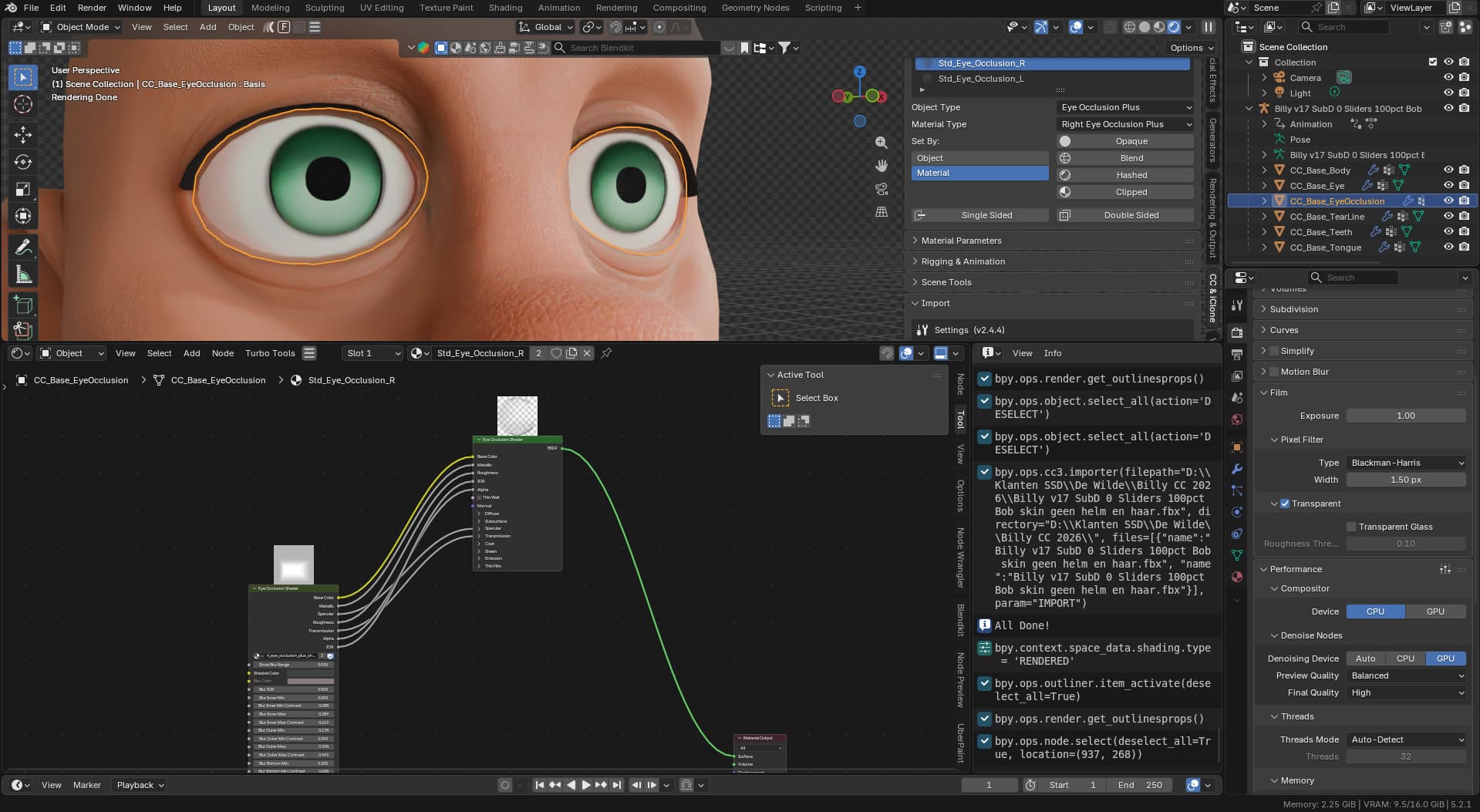

Blender 5.2.1 With Addon 2.4.4. Reallusion Character Bob skin on the character

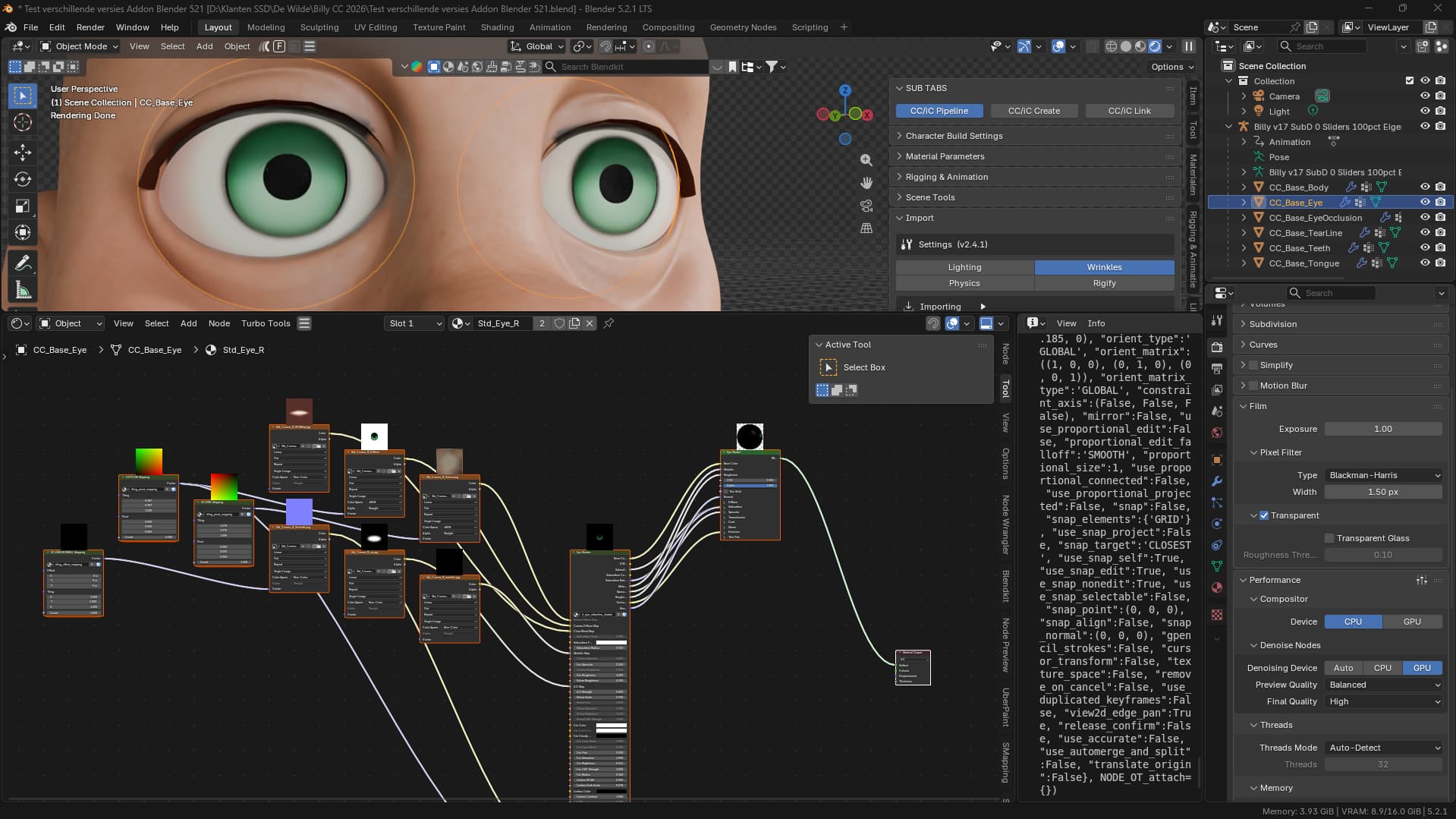

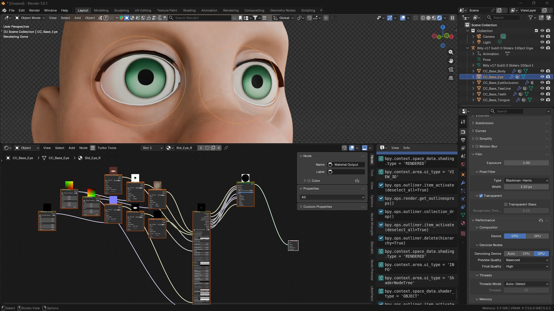

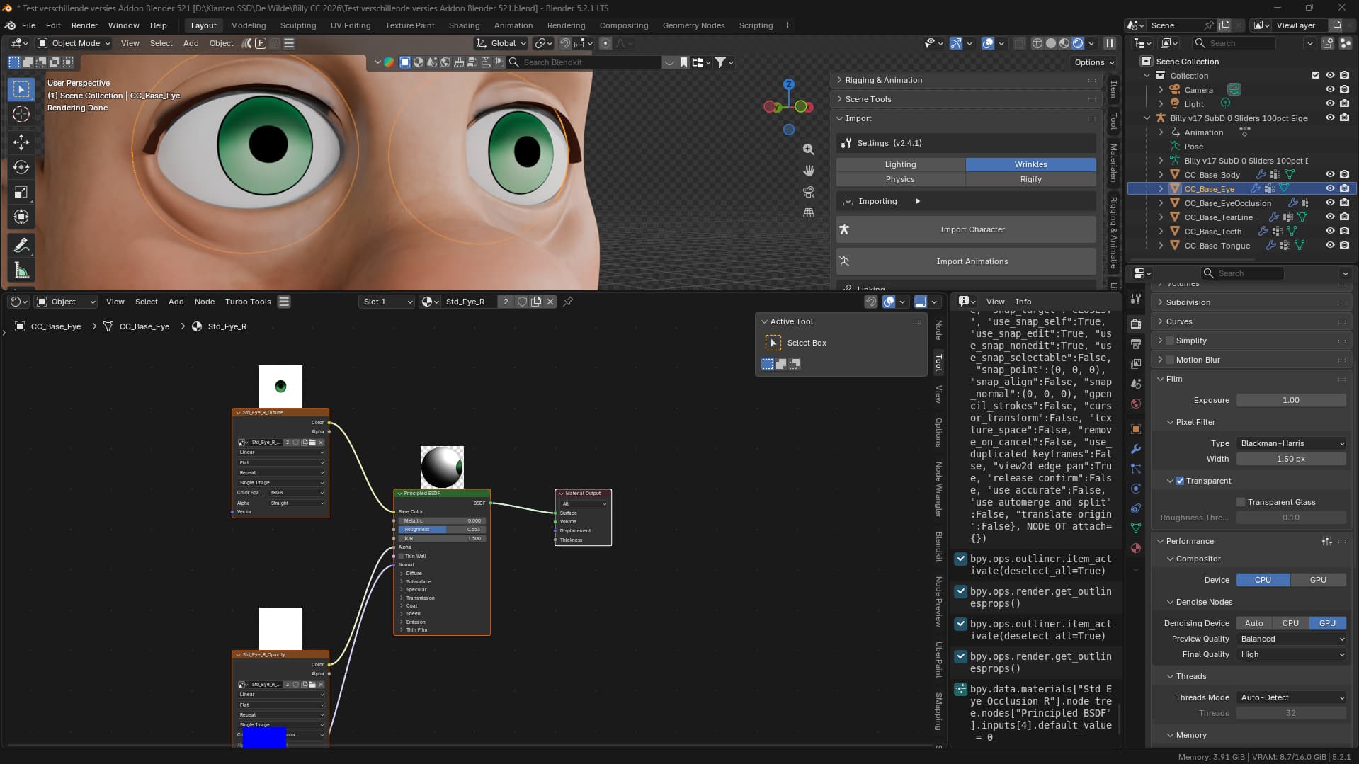

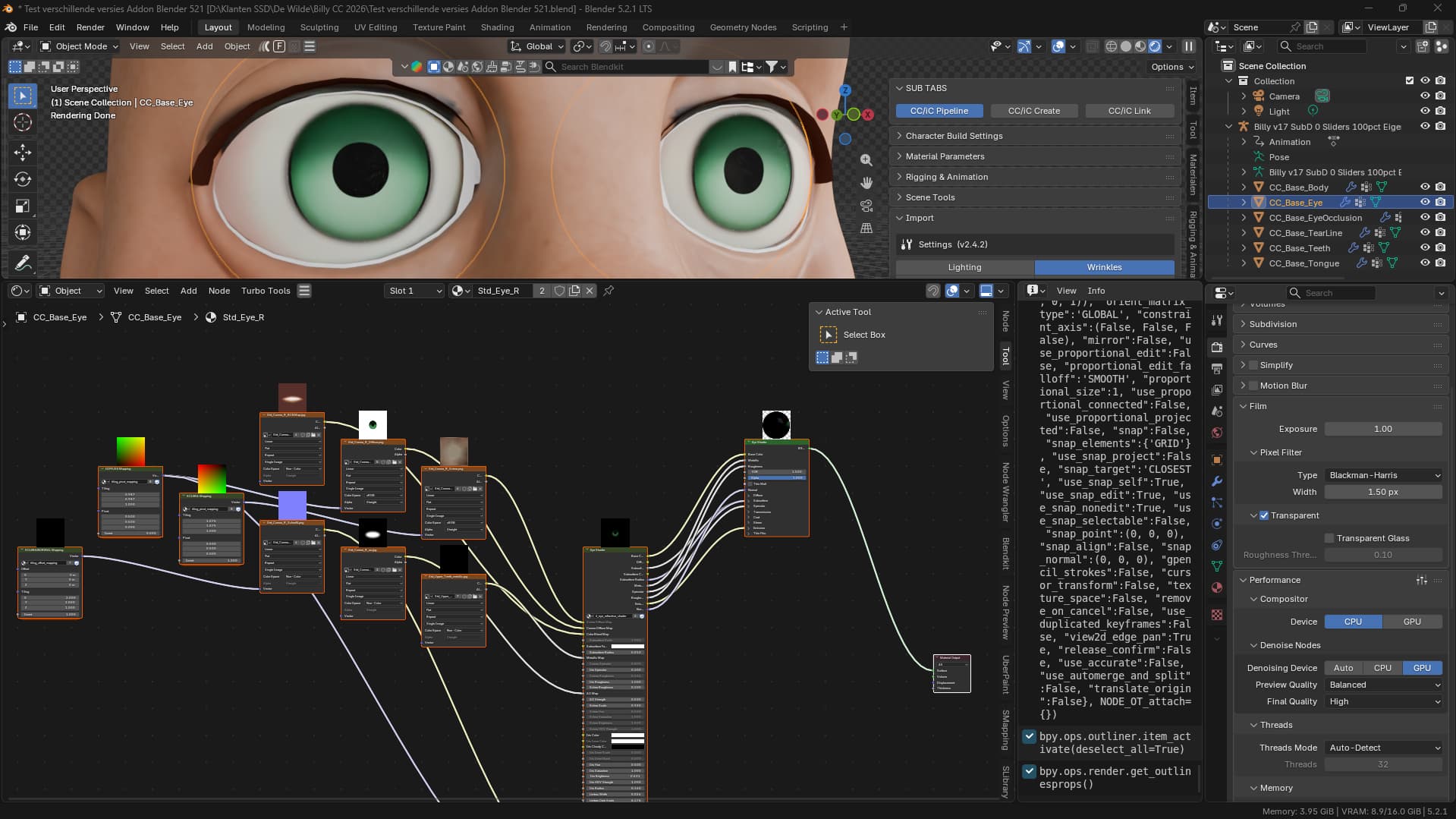

Blender 5.2.1 With Addon 2.4.0. Custom skin on the character

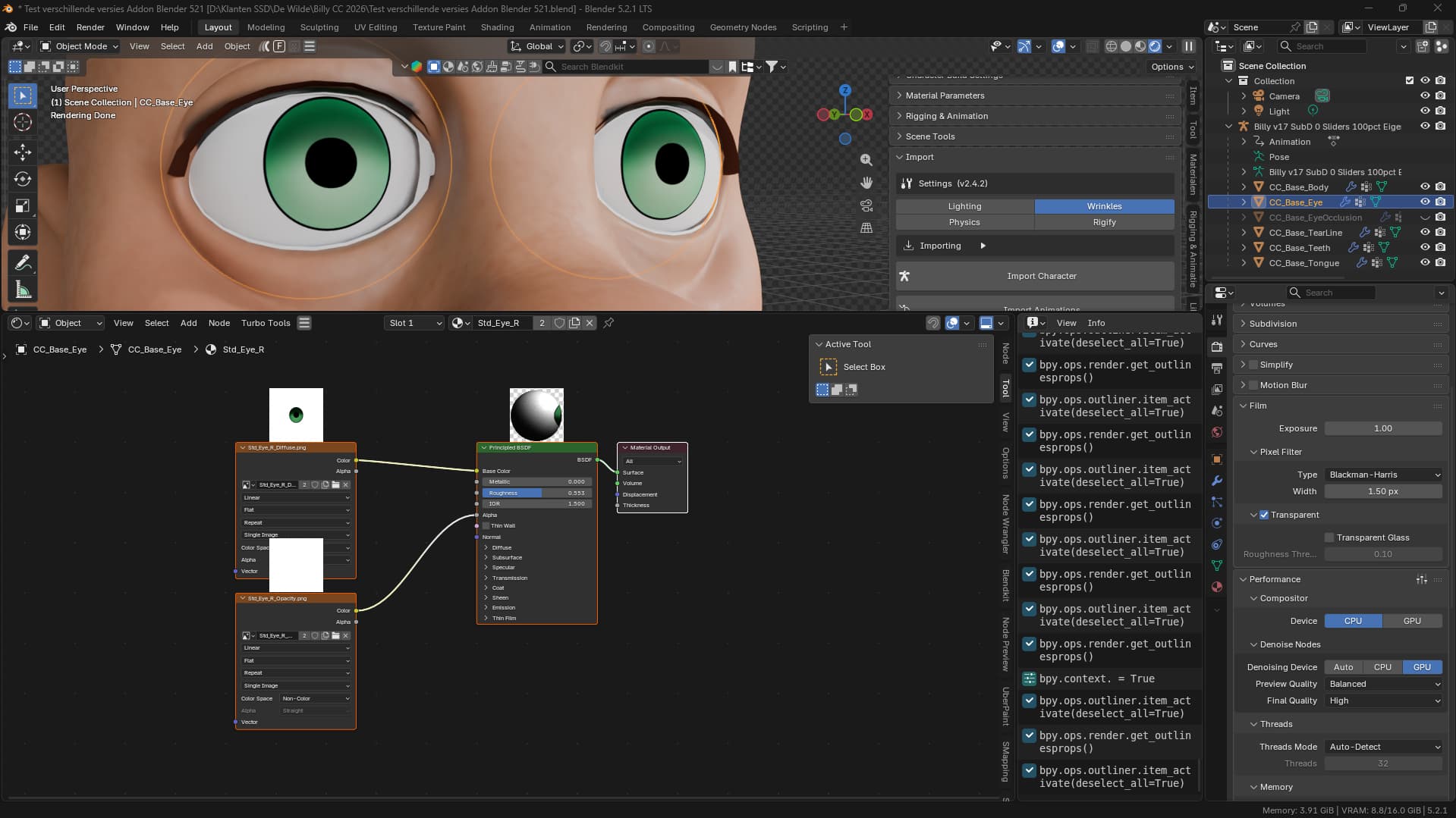

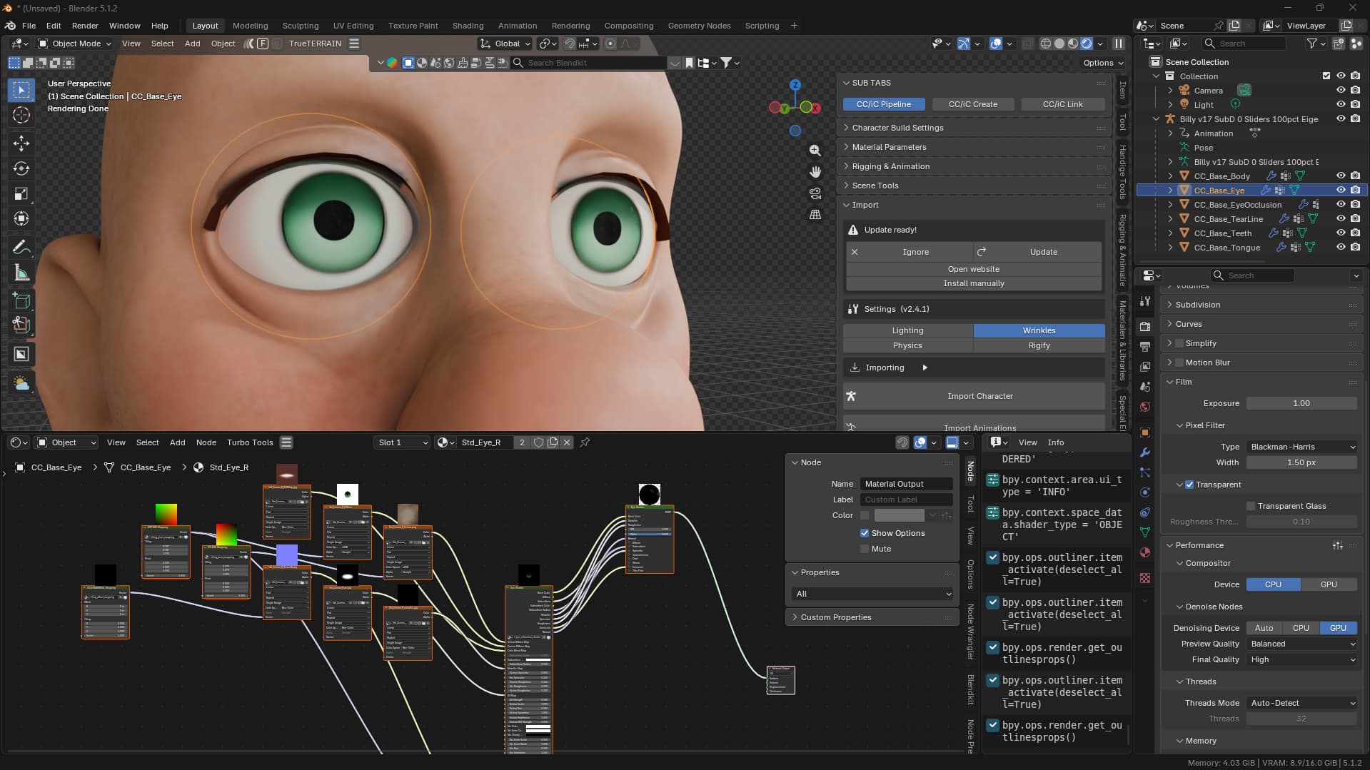

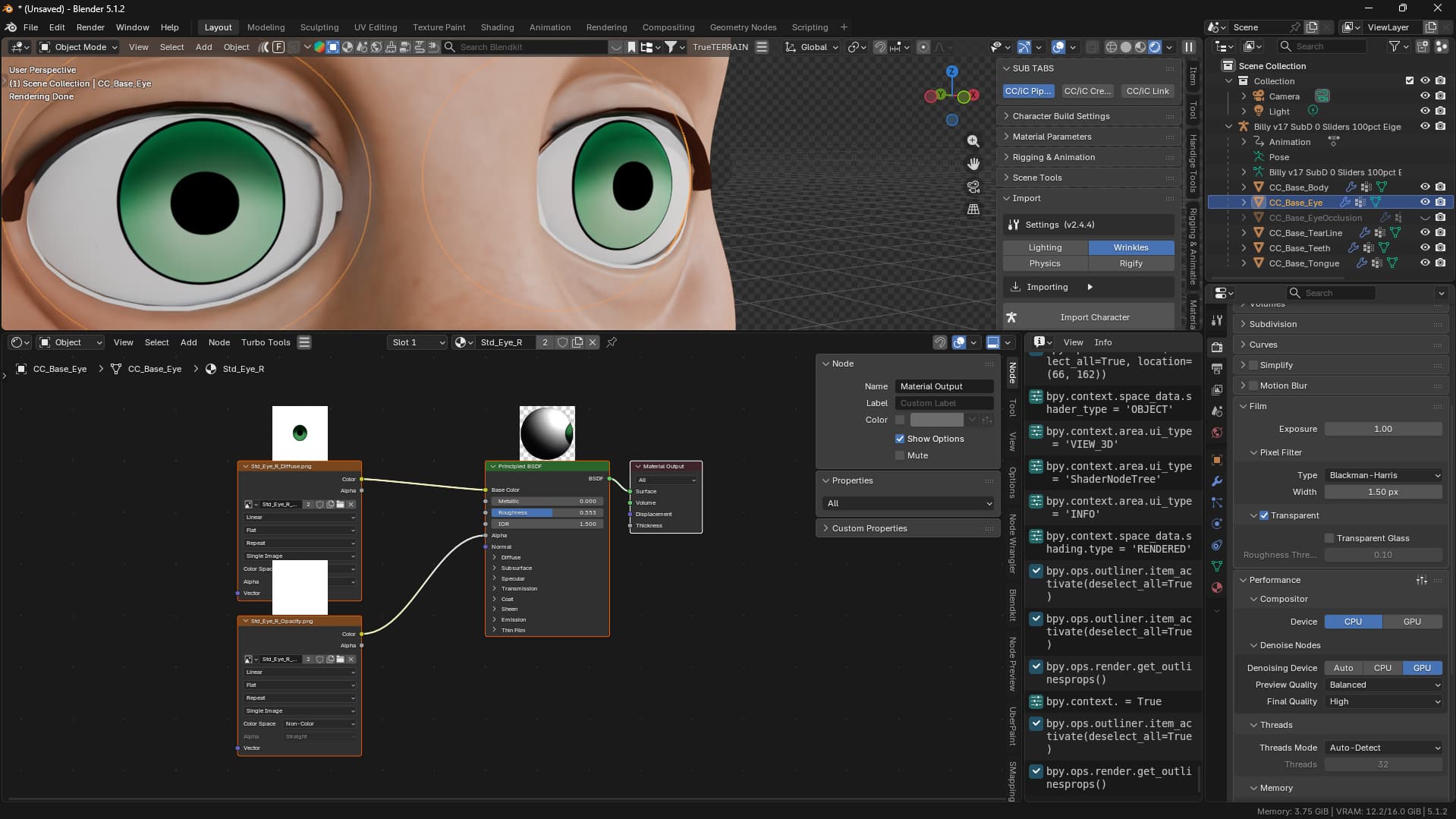

Blender 5.0.1 With Addon 2.4.3. Custom skin on the character

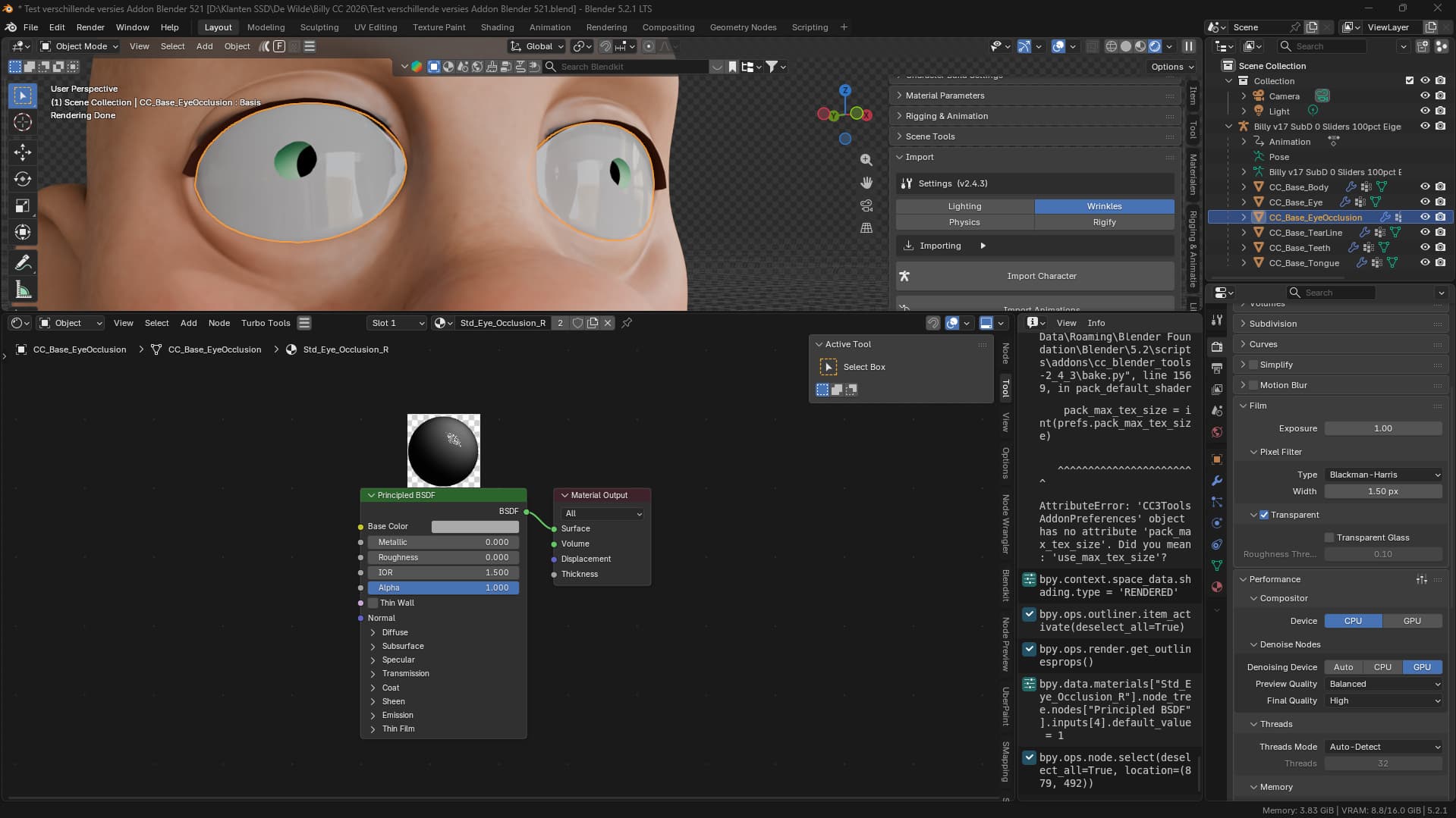

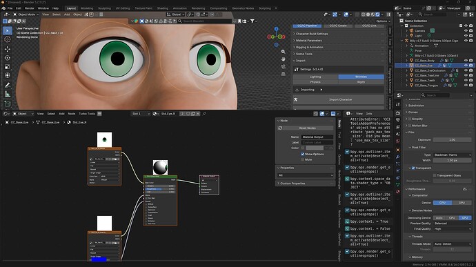

Blender 5.1.2 With Addon 2.4.1. Custom skin on the character

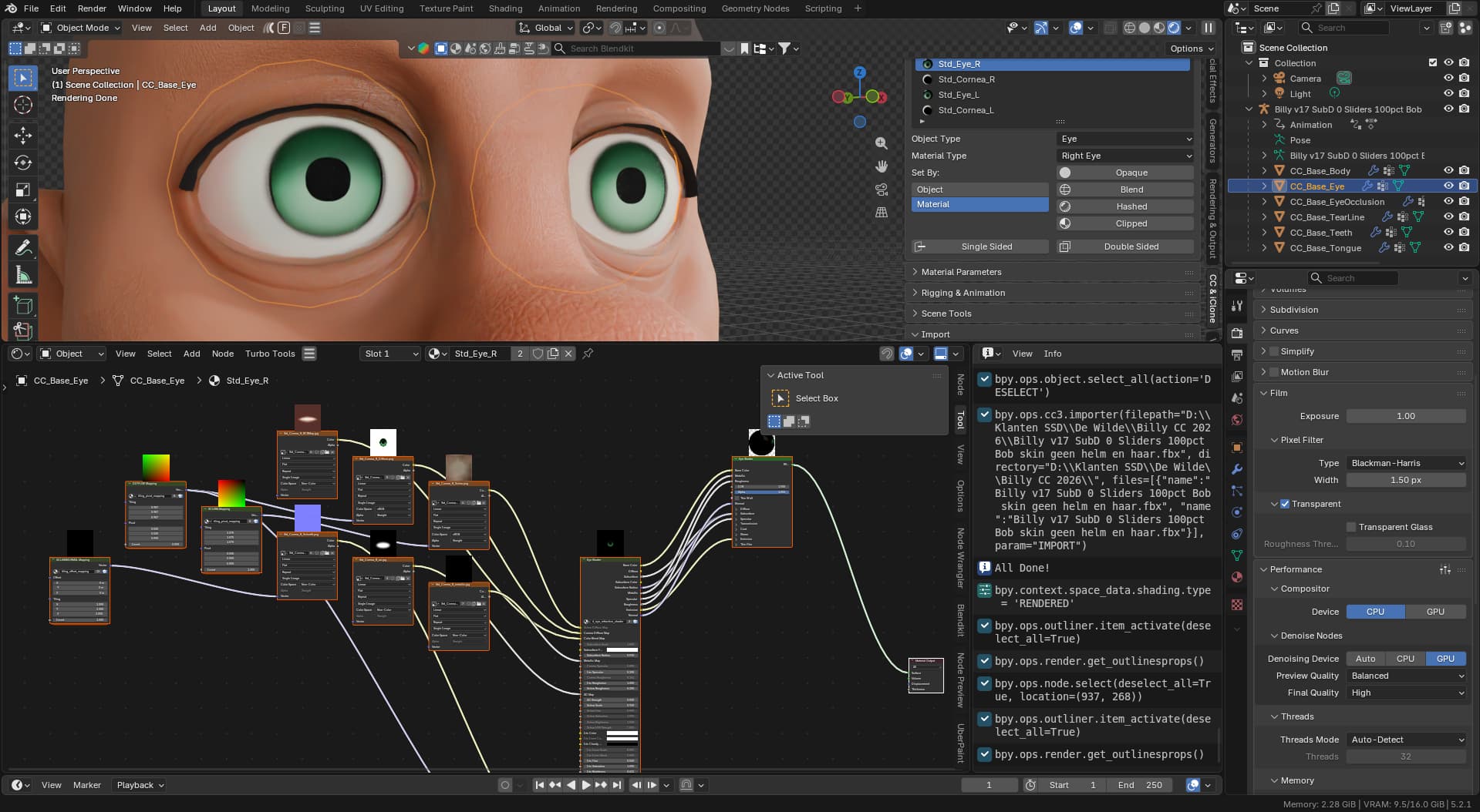

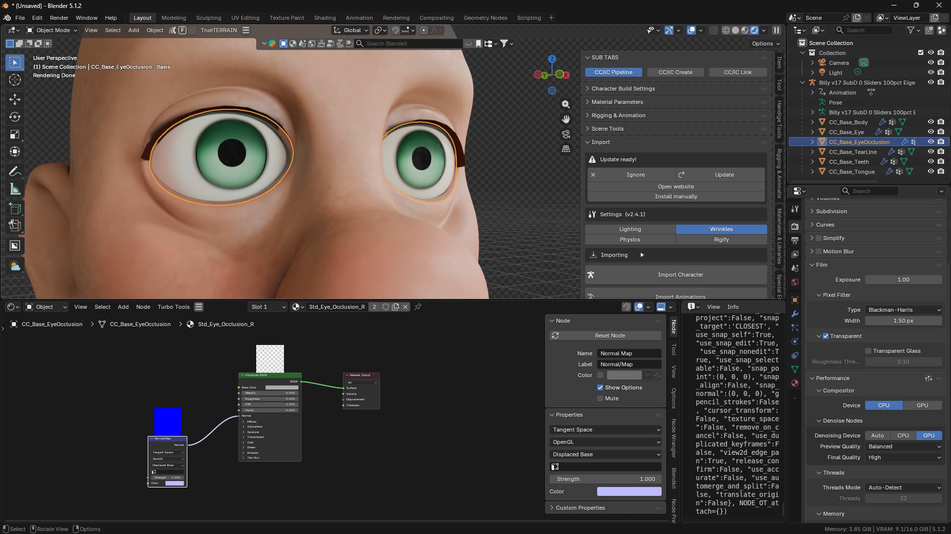

Blender 5.1.2 With Addon 2.4.4. Custom skin on the character

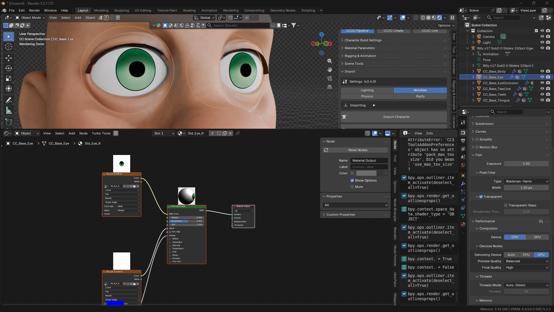

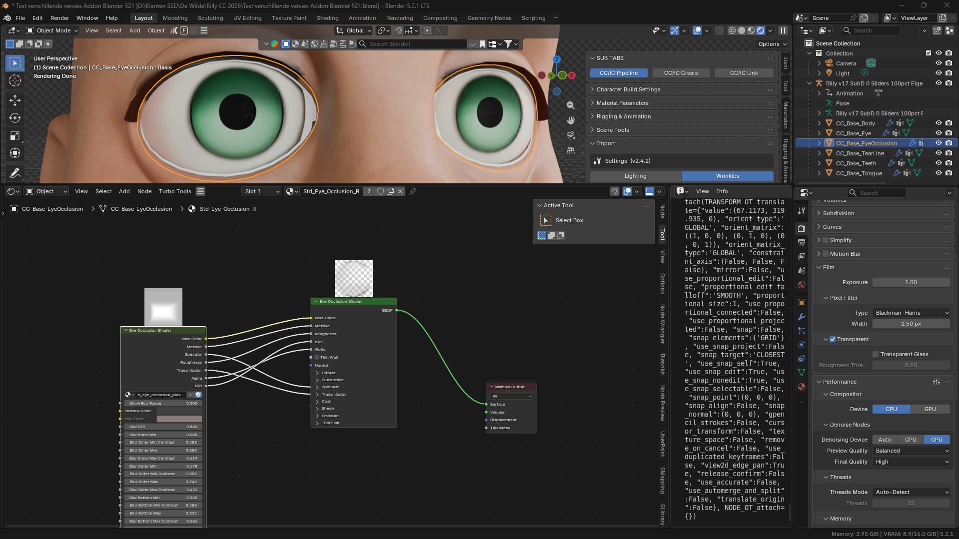

Blender 5.2.1, addon version 2.4.1 first time:
Blender 5.2.1, addon version 2.4.1 2nd time:

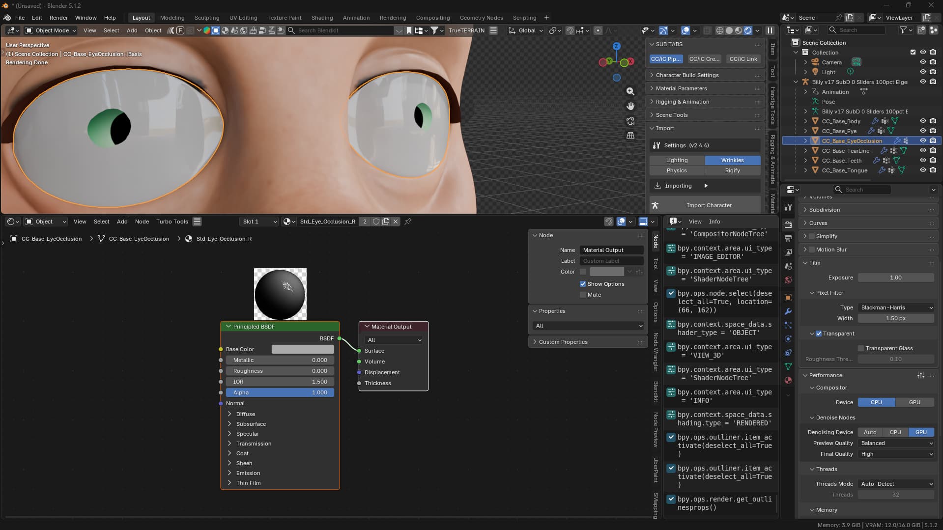

Blender 5.2.1, addon version 2.4.2 first time:
Blender 5.2.1, addon version 2.4.2 2nd time:

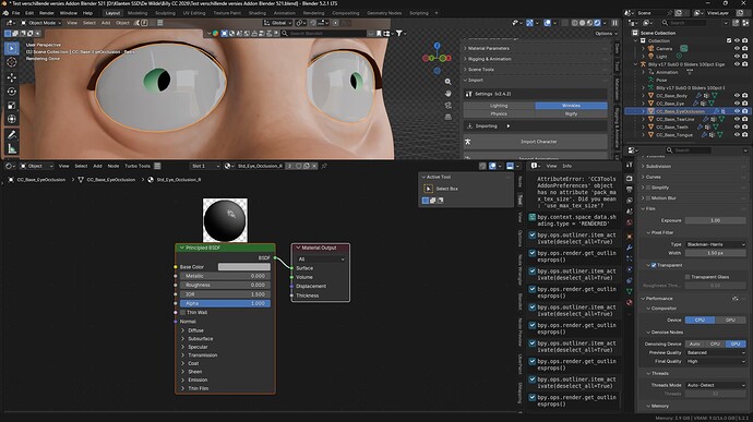

Blender 5.2.1, addon version 2.4.3 every time:

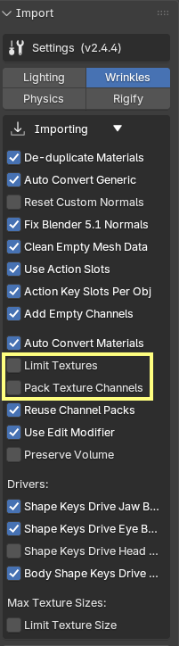

That’s a bug in an obscure texture packing option.
Turn off these two options:
That should stop it.
Hey Victor,
Thank you for your fast reply.
I tried it right away, but unfortunately, it didn’t help.
Any other ideas?
