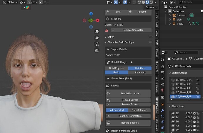

I am using the CC auto setup for Blender add-on v2.2.5. Using the add-on, I import my FBX model, set the build settings to basic, and click rebuild materials. I adjust the “Ah” shape key, and you can see that the jaw opens.

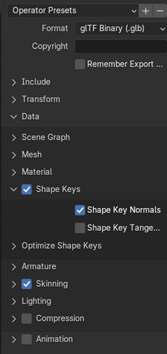

I then export as GLB with shape keys.

Because Blender drivers on the character open the Jaw bones from the shape key value. That’s specific to Blender and doesn’t export.
Shape keys by themselves don’t do anything other than alter the mesh, as you see.

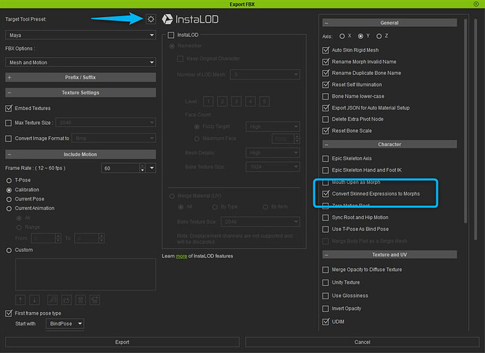

There is an option in the CC4 FBX export panel settings to convert the bone driven expressions to purely mesh blendshapes.

The alternative is to export the character with the option “Convert skinned expressions to morphs” and / or “Mouth Open as Morph”. Which combines all the expression meshes into one object and bakes the bone movements directly into the expression shapes. Which should solve the immediate problem, but it means you can’t animate the head / eye bones directly any more.
It depends what you’re using it for, if that becomes a problem or not.
