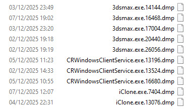

But the software (3dmax) doesn’t crash, it just gets stuck sometimes at 50% and sometimes at 75% and I have to close it (alt ctrl delete)
Which file from this list of files should I upload or send to you? Because each of the 3dmax files weighs 460 megabytes.
