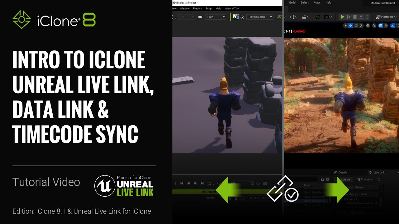

Live Link makes the process much easier, allowing you to transfer everything with just one click. In comparison, exporting via FBX can be more time-consuming, especially when your character has many blendshapes that need to be exported manually.
You can refer to the Live Link tutorial in this video:
