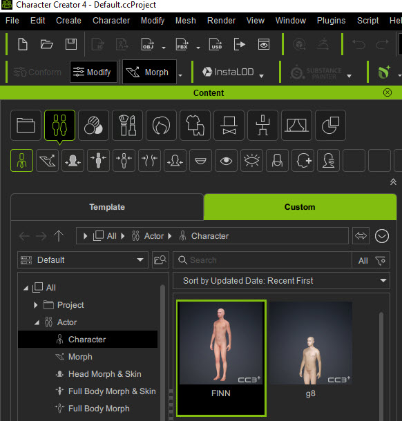

I meant exporting G8 or G9 from CC via the CC Auto Setup plugin.
Hi eliezerbh,
We regularly accept files from G8 or G9 imported to CC. Not quite sure about your case; could you kindly screen record your workflow for us to better understand the issue.
Thanks
Maybe I’m doing something wrong in exporting from DAZ to CC or exporting from CC to max
So here’s my suggestion
Maybe you could please make a video showing the export of G8 from DAZ to CC and then exporting G8 from CC to 3dmax and importing with CC Auto Setup with Vray and if it works I’m willing to pay you $50 Through a PayPal account
Hi eliezerbh,
No worries about the payment. We will follow the steps you provided using an embedded Daz character and record a video of the process. Please allow us some time to prepare the video and ensure everything works properly.
Thank you for your patience.
Thank you for your response and willingness to help. I will patiently wait for your response. And I still say that I have no problem paying for this service. Because this issue is very, very, very important to me.
An important point (perhaps) to clarify: I am working with Character Creator v4.71 and not version 5.
Hi eliezerbh,
We replicated your workflow and confirmed an issue when exporting from Character Creator to 3ds Max. Thank you for bringing this to our attention. Our team is working on a fix, and we’ll keep you updated on the progress.
