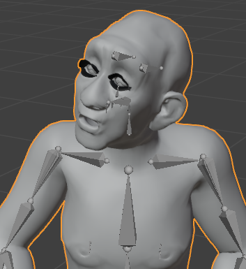

Hi, I’ve done some tests with your file and exported to blender.
However, the .fbx exported on my end included all body motion, expression and viseme(lips movement).
Would you submit a screen recording of how you export and how it behaves in targeted software to my email for us to check?
Still, here’s a potential workaround that you may try: using the Collect Clip Track.
1.Open collect clip track in the timeline.
2.Drag to select the frames you want to be included.
3.Right click the clip you just created > save > save Motion Plus.
4.Delete all track, drag in the new Motion Plus file.
5.Export the character as .fbx file.
Please let me know if this works!
