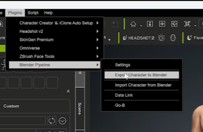

I’m following this tutorial, but the first step does not export the character.
https://youtu.be/qbEPh6BkbYc?
The “Import Character” button opens the dialogue window, but nothing at all happens on export.
Looks like an older menu, you could have old versions of the plug-in still installed. Remove all but the latest version from the OpenPlugin folder.
Or remove them all and re-install the latest to be sure.
Thank you! That did it. There was an older version in the OpenPlugin folder. I deleted all versions, uninstalled them from the hub, and then reinstalled them, and it’s working.
