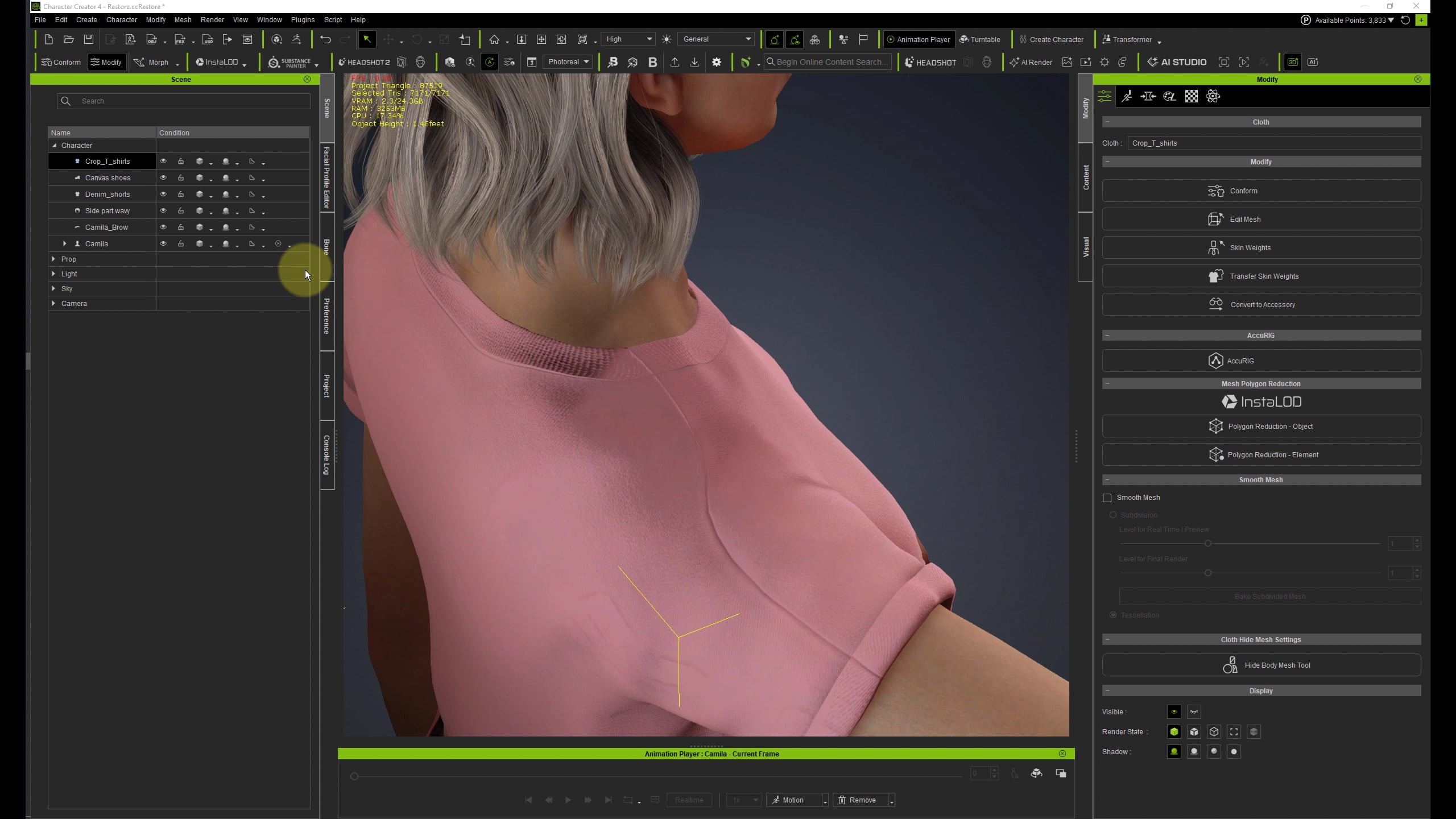

After applying clothing to a characters, I sometime find the characters mesh is poking through the clothing. I try the conform function, which sometimes either fixes it or improves the poke through, but doesn’t completely fix the problem. So I then choose the ‘edit mesh’ function from affecting clothing items modify panel. I know I can hide the characters mesh under the clothing, but I don’t always want to use this method.
The problem is when I hit ‘edit mesh’ and the mesh appears, the poke through is no longer visible. If it’s a fairly big area poking through, I can still see it, but if it’s only minor I can’t see it when the mesh is visible. So I’m forced to keep toggling the ‘edit mesh’ button back off, try to remember which part of the mesh has the poke through and then hit ‘edit mesh’ on again and take a bit of a guess at sculpting or editing the relevant faces. Then toggle the edit mesh back off again to see the result. Sometimes it will take several cycles until I’ve successfully edited the mesh sufficiently to cover the poke through.

But this is hat I meant:
