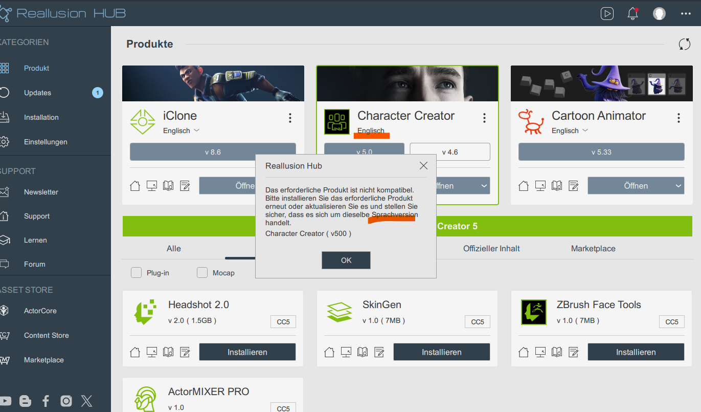

Hi Hans, seems I’m having some trouble installing HS2. I have CC5 already installed but I’m getting this error:

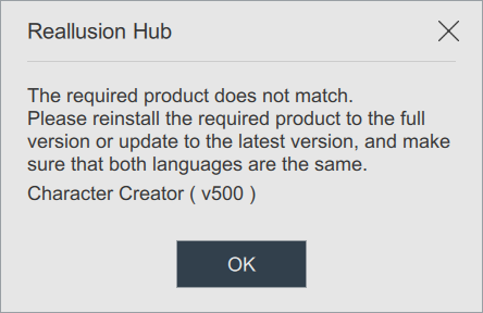

Yes, thanks, Hans for the activation link. I also have the error when I try to install though.

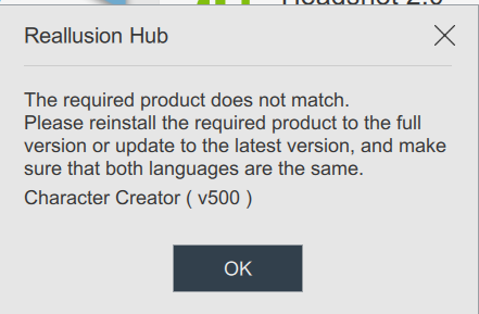

Yes:
It says, please install again , make sure it is the same language version.
the last version in cc4 was V 2.02 - in reallusion hub when switching to cc5 it says V 2.0.
maybe someone put in an old version of HS in the install-link. this old version is not comatible with cc5 i guess…
Apologies for the issues with the Headshot 2 plug-in for CC5. The issue is being investigated and should be fixed soon.
