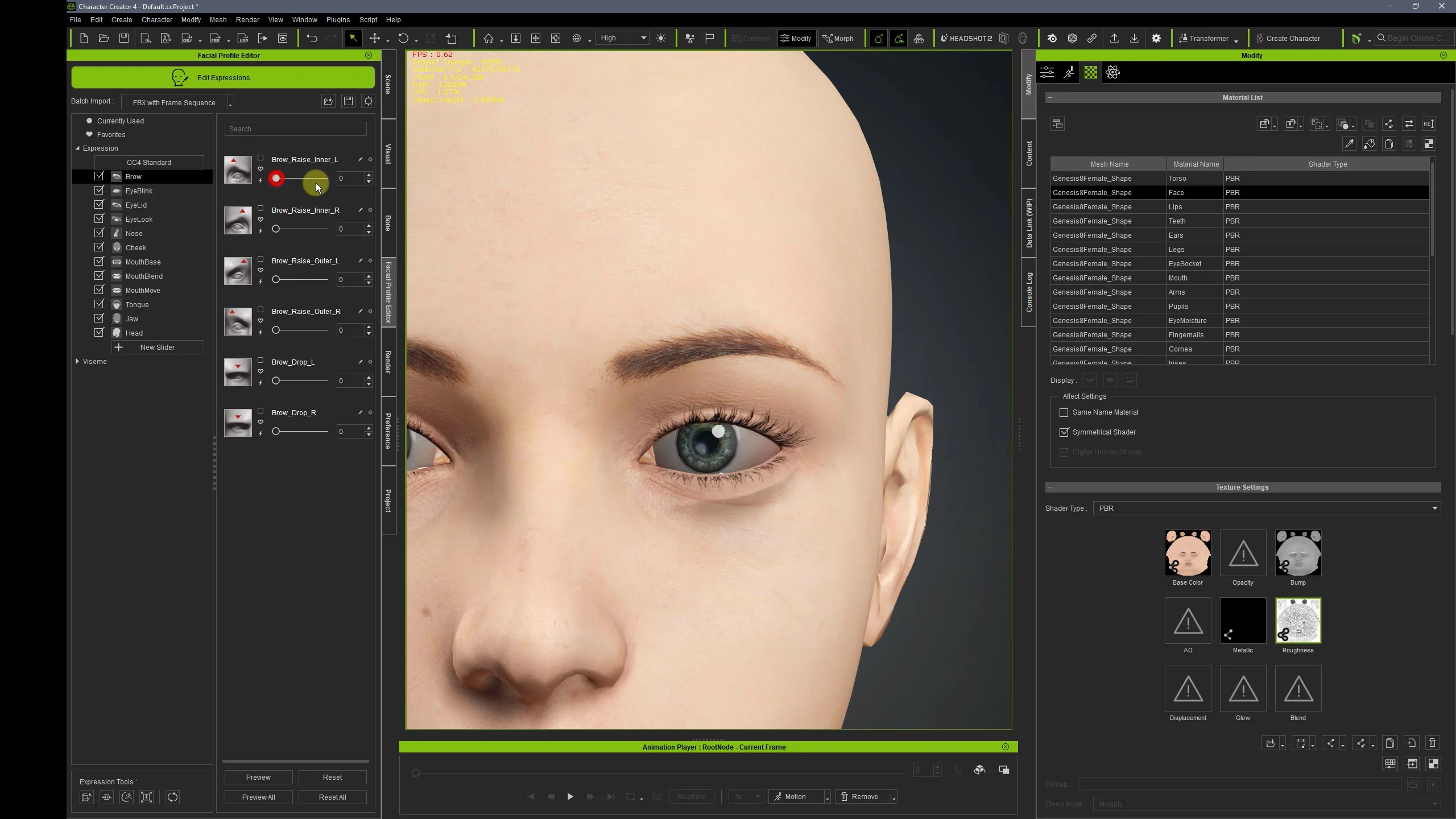

Regarding left eye for Gen8 profile (if you ever need to use it), it’s not hard to fix either (a little time consuming). You essentially need to zero out left eye bone rotation by Z axis for 26 blendshapes. Starting with 2 and up to 27 in sequence. The fix should cover ALL Visemes, Brow, EyeBlink, EyeLid sections (there are couple which do not need a fix). Then you may save profile for the future.
Here is a sample fix:
