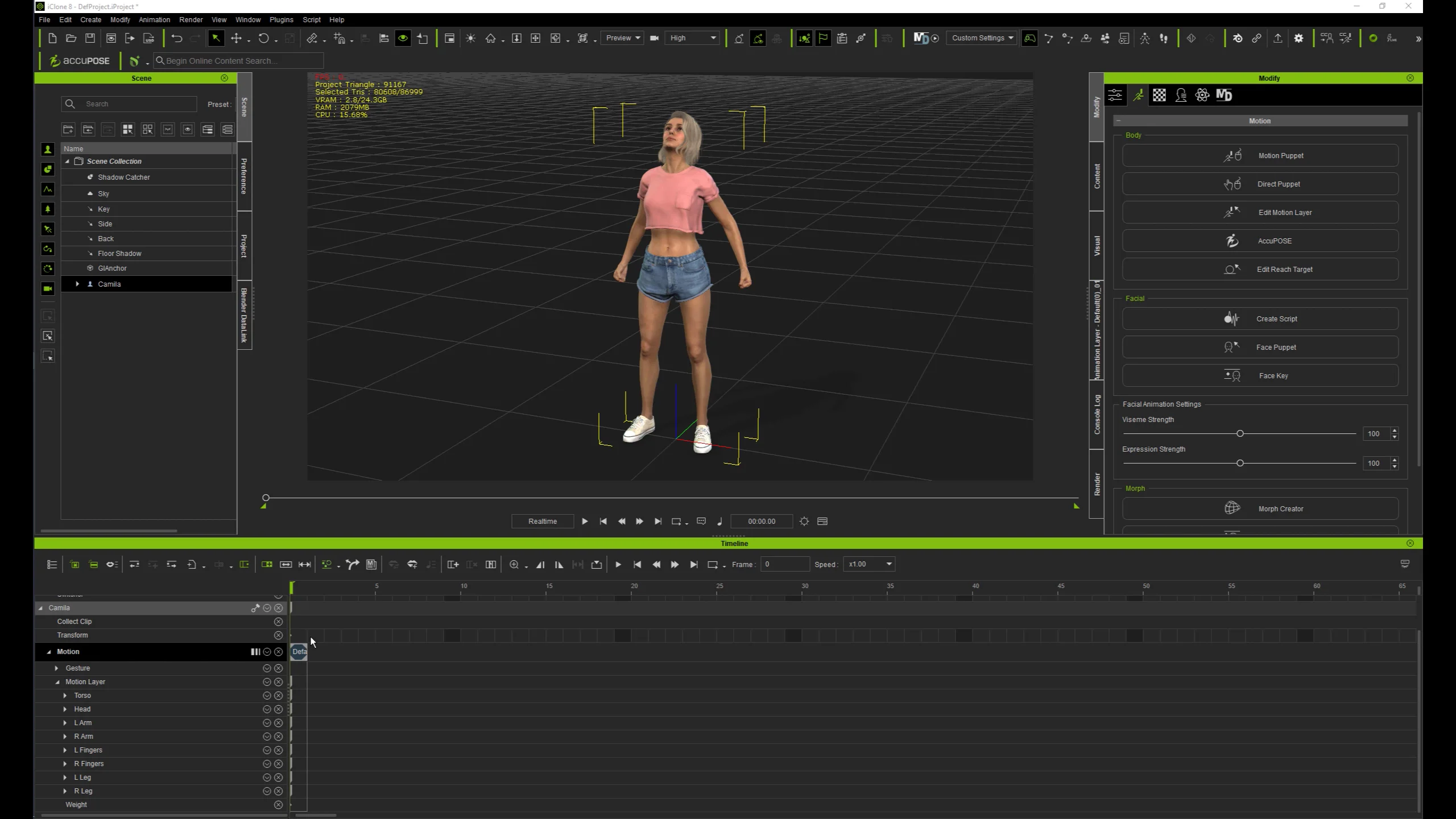

Thank you for your reply! I appreciate your help, but unfortunately, it didn’t solve the issue. I copied the pose, applied the Motion Clip, and then removed the relevant keyframes. However, when I played the animation, the original pose still appeared. I was hoping this method would resolve the issue, but it didn’t work as expected. Any additional guidance would be greatly appreciated!
Do you also know a solution to my other problem? Somehow, I inadvertently recorded the adjustments I made to my avatar’s pose and now, when I want to start the animations, the avatar changes into a different pose, and the camera zooms out—automatically. There are no visible keyframes in the timeline, that I can see. These changes seem to be baked into the project.
I hope you can shed some light on this. I’ve been at it for a couple of hours, tried different things, but nothing works.
https://youtu.be/DDX6N7smEtk
