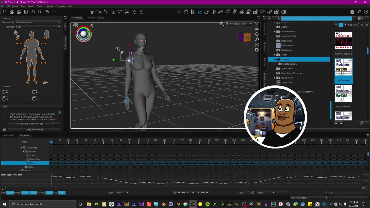

Even Daz studio’s Motion clip& graph editor can do this accurately
The problem most here seem to be having with Iclone’s curve editor ,is that the unpacked or Baked motion Data seems to be unstable and vanishes randomly making the curve editor difficult difficult if not impossible to use effectively
