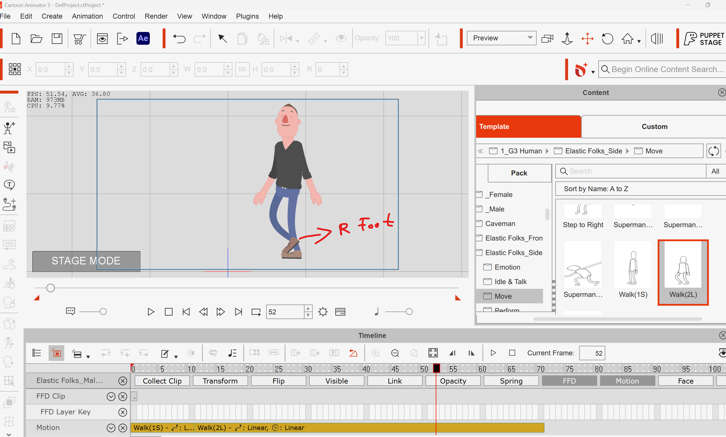

Hi,
In CTA5, the Elastic Folks Side Walk2 animation seems to have a layering issue — the RFoot layer appears above the LThigh at a certain point. This also happens when using your sample G3 character with the same animation. Other walk animations work fine.
Could you please advise how to fix this?
Thank you.

Hi…
Thank you for the notification. I will pass this on to the content team.
However, it is very easy to fix the issue by doing the following:
  1. Move to the problem frame number as shown in your screenshot.
  2. Open the Layer Editor from Menu Bar > Animation or press L.
  3. Select RFoot and then click the “Sent To Back” button.
  4. Now click on LThigh to move the right foot to the correct position.
Now when you play back the project the issue should be resolved.

UPDATE:
The issue has now been fixed. You can download the updated Animation pack in the Free Resources section of Content Manager.
