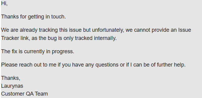

Final Update: I’m not crazy
Unity confirmed that it is a bug and they are working on a fix. I have no idea what the issue was, but wanted to share in case anyone else is encountering the same issue right now.
