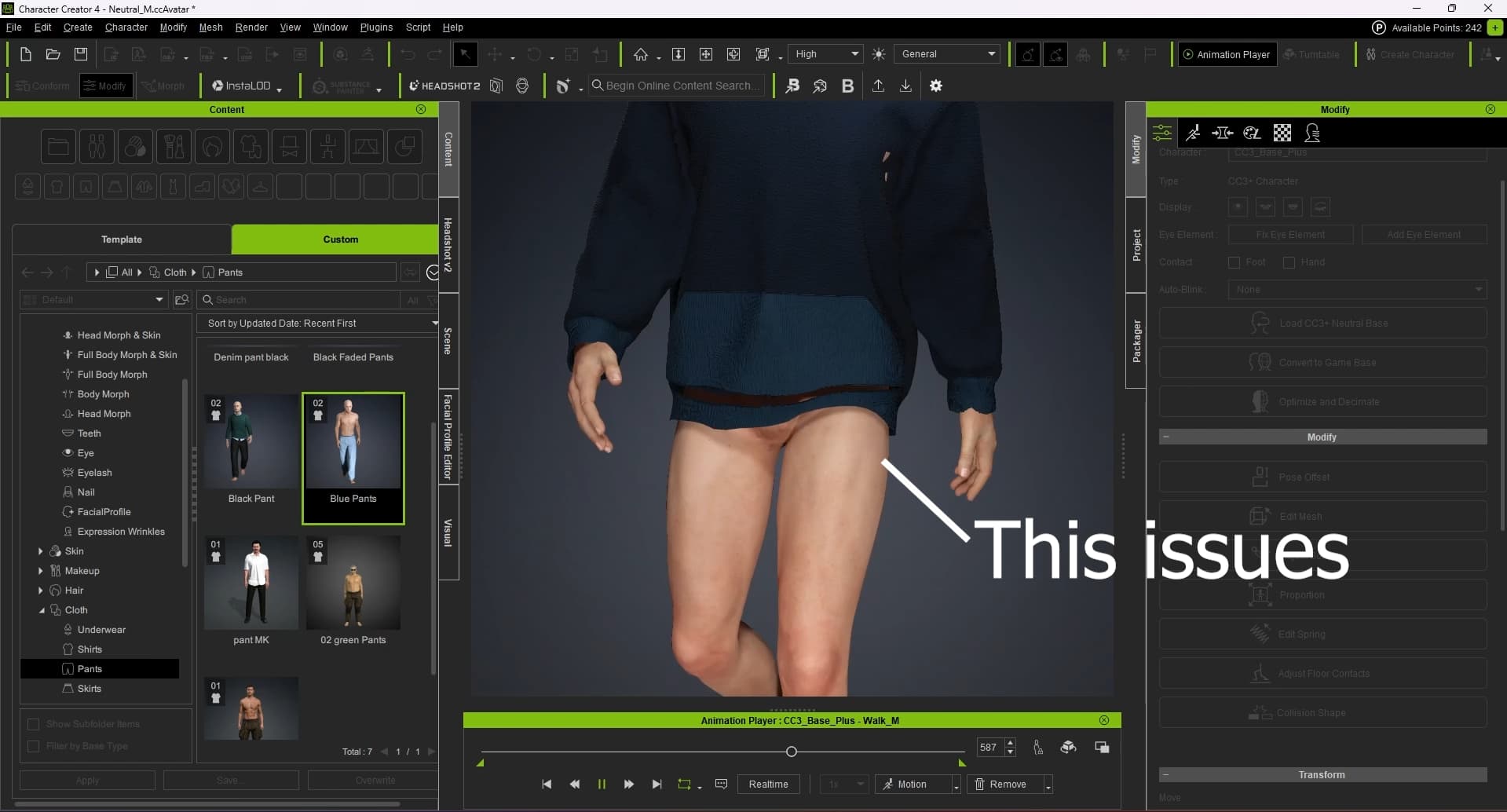

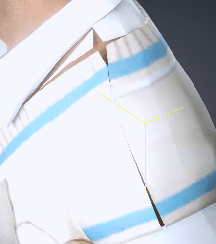

This is not coming out properly, and the seams are opening. I am facing a lot of difficulty with this issue. Why is this happening, and how can I stop the seams from opening?
Please tell me how to fix this in CC4, and share any helpful websites or reference videos.”

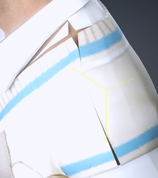

Cloth items have to be a solid mesh. Solidify/merge mesh, or export with perspective settings in your cloth design apps (MD, Blender, etc ). But it can be identified and taken care in CC with Weld Vertices nowadays as well (if seams are not visible in default/bind pose). A quick guide:

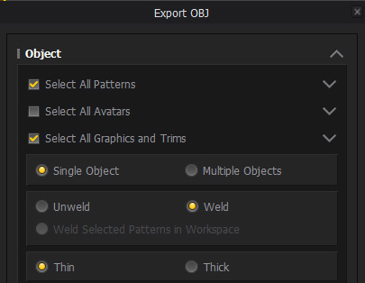

This is what I usually recommend for MD export:

Thank you, 4u2ges! This is a huge help to me. I was having an issue with MetaTailor, in that it “cuts up” exported/re-imported meshes along new seams, which made it hard to further edit in CC, and would fall apart when I tried to add physics, but this takes care of it with one click! I had asked on a MetaTailor site and hadn’t gotten an answer, so I’m really glad I caught this discussion!
