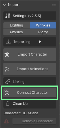

  • Select the copy and reconnect the character to the source blend file (or source fbx file). This will pull in all the character meta data and let you use the character as if it had been fully imported.

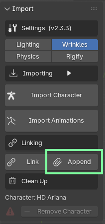

  • Use the append function and it will bring the character in and connect it automatically.
  • Note: If there’s more than one character in the Blend file, it will bring them all in.

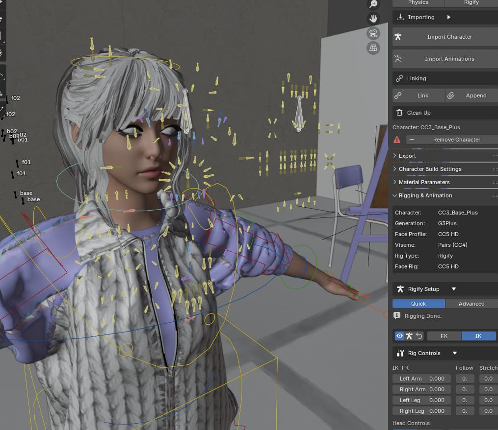

But the second way seams have a little bug, you can see it at my screenshot, the facial control lost all of UI
