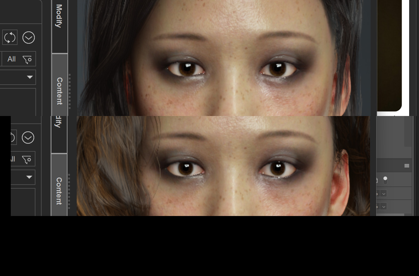

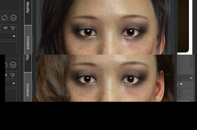

Hi, On the latest version of CC5 (5.06) I’ve noticed that changing the character’s hair changes the eyeball scale and possibly some surrounding shapes (around the jaw and cheeks).
It’s definitlely most obvious in the eyeball. I’ll attach a before and after.
I made the character using the Headshot 2.0 plugin if it helps. Although I’ve worked with the same character for a while without this issue.
Reverting back to CC5.05 seems to fix the issue for now.
Is this the best place to report as a bug? It may be something I’ve done incorrectly but I think it’s an issue on the latest update.
