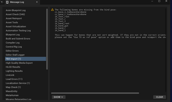

I’m getting the following errors when importing a character via FBX export from CC5 to UE. Screenshot is attached.
I got the same .
Instead when I clicked on the box USE TO AS REF POSE … no
What would be the right thing to do? Why do they advise against clicking that option in the Reallusion tutorial?

About this topic I acctualy always export by cheking that option .
Here I did it, and the result is ok
