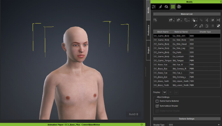

Hi evilbition,
Running Optimize and Decimate converts the shader to standard PBR (see Image 1).

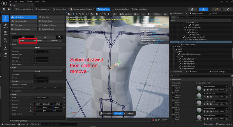

To avoid this, please use the standard CC5 export process and delete the breast bone only after you’ve imported the Digital Human Shader into Unreal Engine (shown below).
