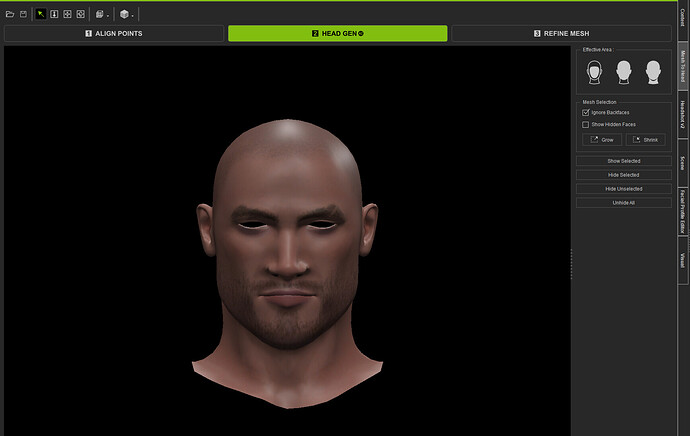

CC5 Headshot 2 garbage mesh

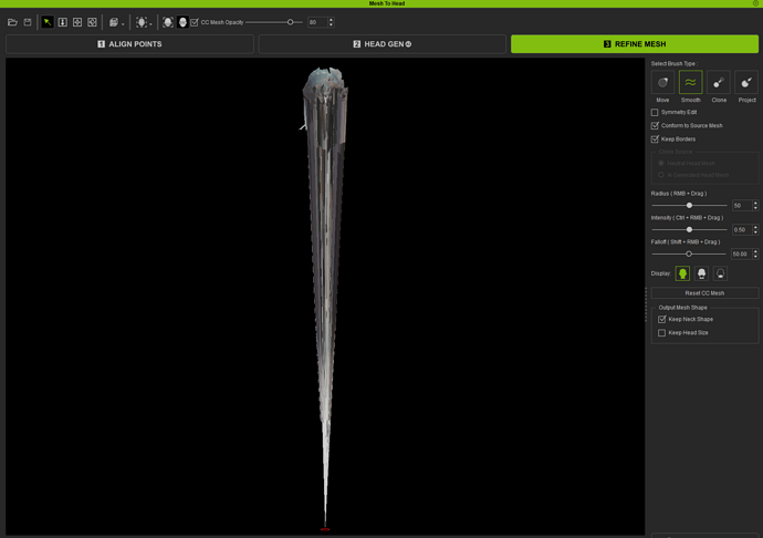

Ok - I’m at the “Head Gen” section in CC5 and it looks fine. I then go to “Refine Mesh” and I get what looks like liquid metal.
The fix- the character was exported from Blender. You have to insure that the ORIGIN is set to the character’s GEOMETRY, not the world origin.
