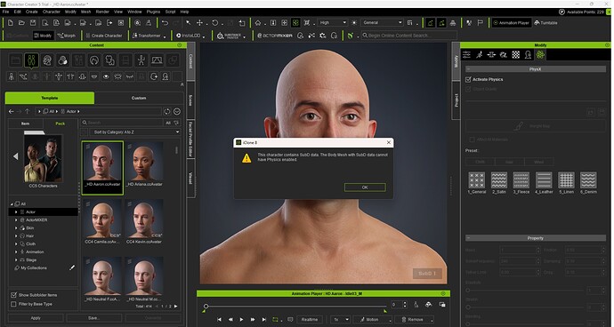

I am just playing around with the Trial while waiting for the redeem code. One thing I use on my characters is physics using the soft cloth, I loaded up one of the HD characters went to the modify tab pressed activate physics. It says ’ This character contains SubD data. The body Mesh with SubD data cannot have physics enabled. Improving the details of the characters in CC5 but can’t do that anymore? Hopefully there is still a way to do it.
Because SubD level characters have three layers of mesh data that are linked together, we do not support enabling SoftCloth on SubD body meshes at this stage. Sorry about this.

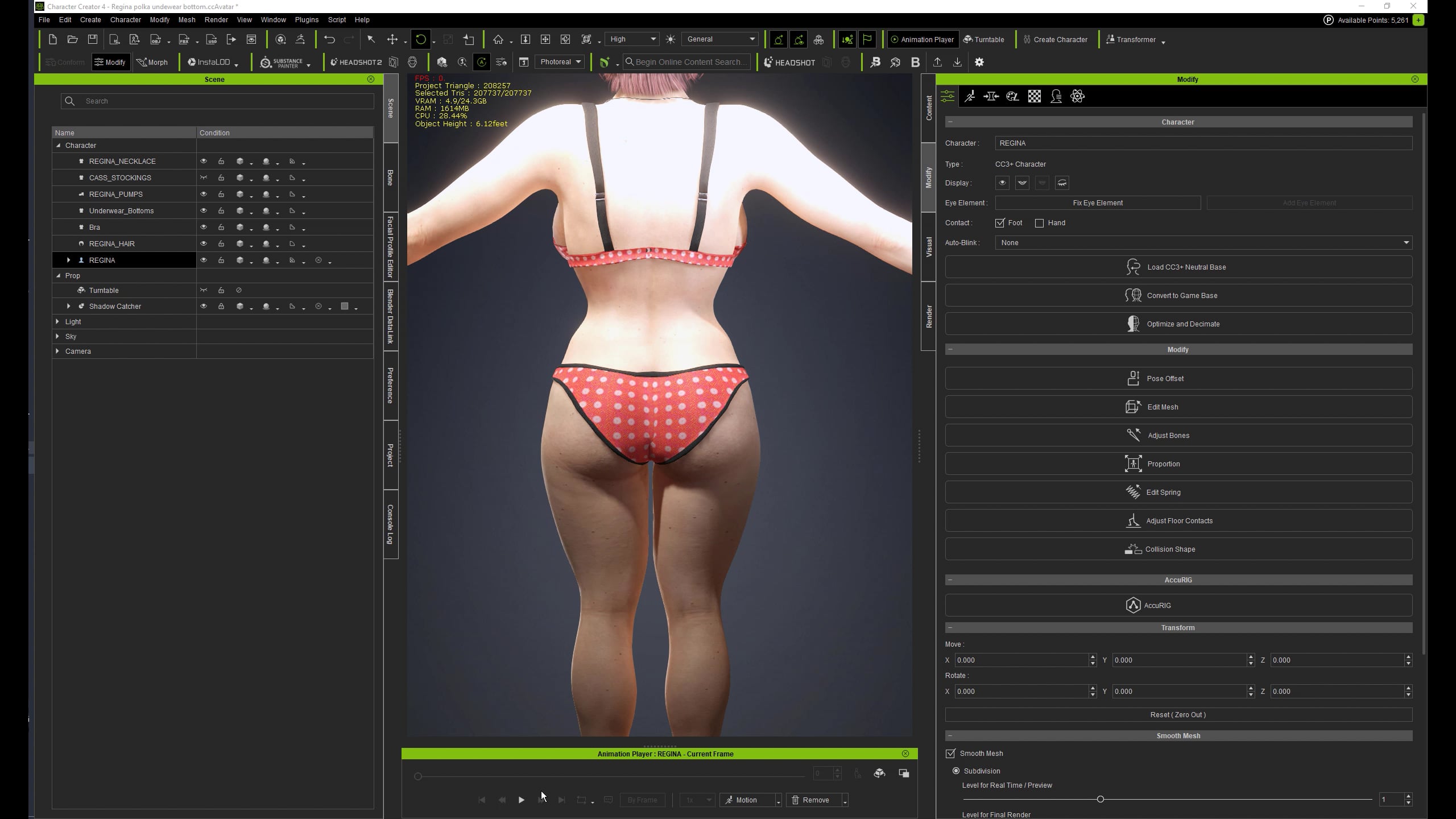

You can download sample weight maps for body parts from here: https://marketplace.reallusion.com/camilia-soft-body-physics
And then customize them to your needs. But evidently, it’s only going to work on regular CC3+ (even traditionally subdivided) characters without CC5 SubD.

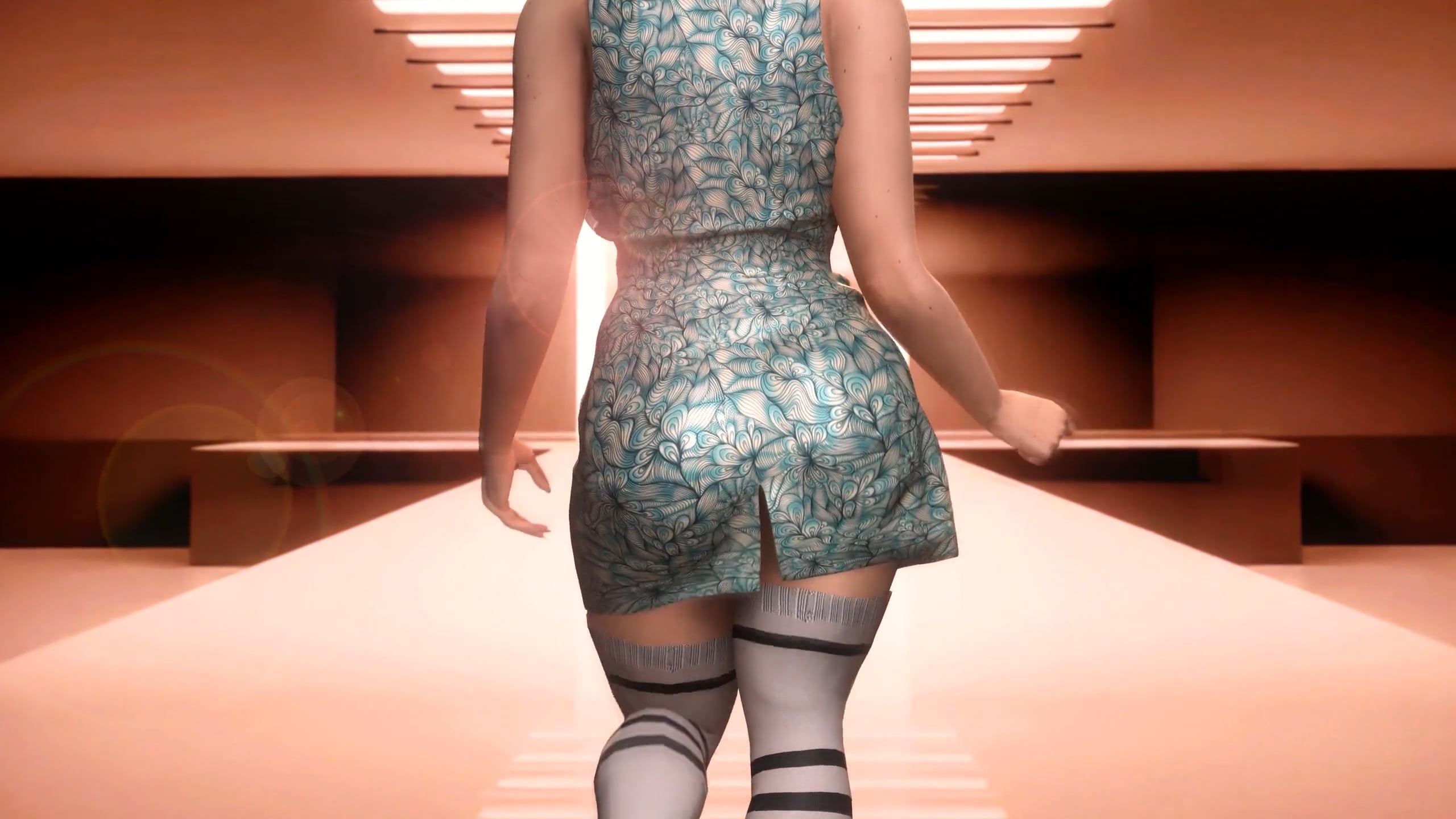

The only problem is cloth. It needs to be simulated outside of iClone (like Marvelous Designer) as it’s hardly possible to synchronize body and cloth physics in iClone.
This one was synced in MD :wink:
You can actually rig clothing as facial hair, and it will follow physics jiggles. You just need to set a custom facial hair vertex assignment for the body region instead of the facial region preset. Might be fun to play with.
Still not perfect, as you cannot rig a skirt properly as facial hair.
That’s the whole point - to conform mid and lower body sections :grinning:
I’ve been actually playing with it a lot in the past and I was sticking with Hair (Base/All). It works whole lot better than facial hair when it comes to covering some body parts (like I did for Batman character). It does NOT work for arms and lower legs though, but for underwear and for some types of skirt it might work well.
Here is how:
Yet I still prefer MD as it creates whole lot better sims and there is no need to worry about cloth physics in general.
Same animation as referenced in the other post but with dress:
