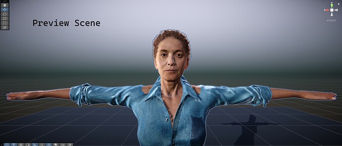

I’m having two main issues around exporting characters to Unity - I’m hoping someone with some more experience in this workflow could give me some guidance.

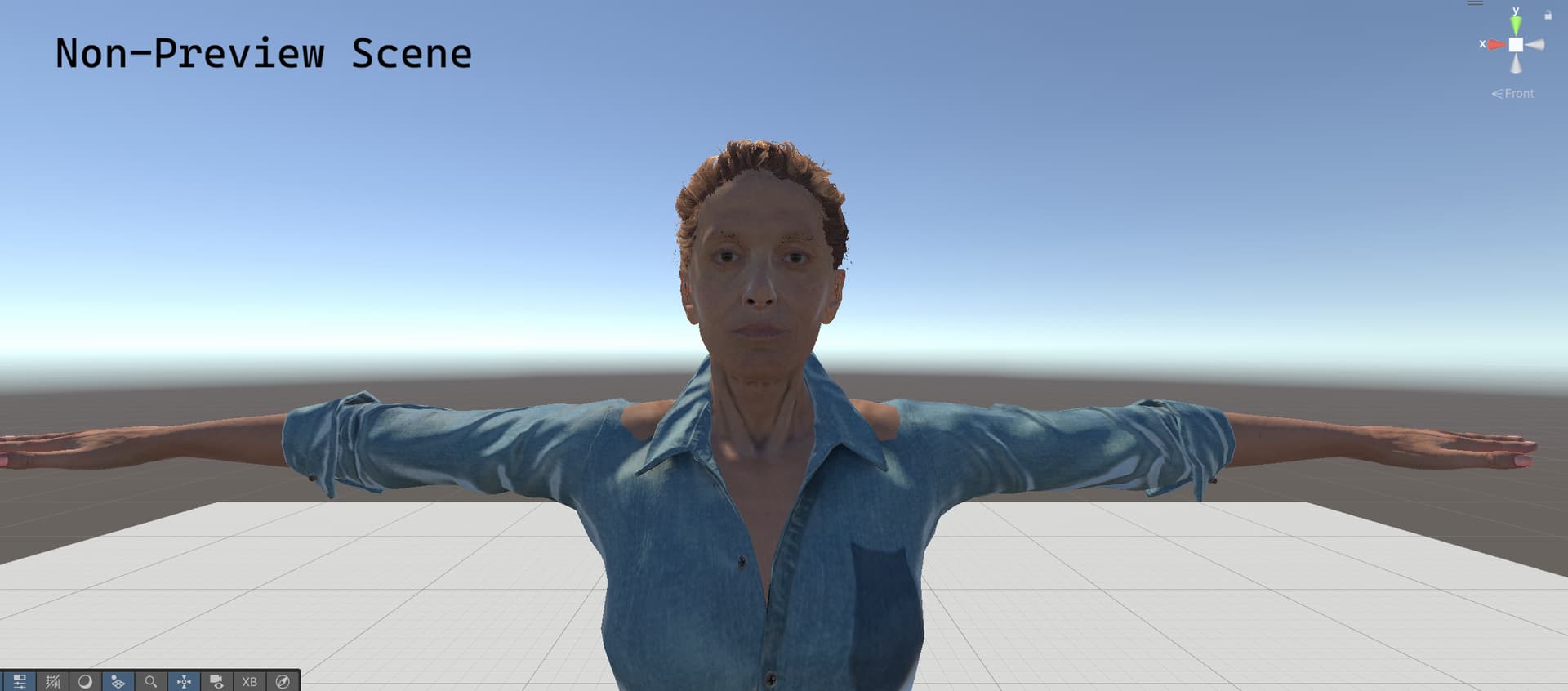

  1. In a basic scene, it seems like my eyebrow shaders are not fully rendering? The character seems to eyebrows seem to be missing or blow out. However, when I go into the preview scene from the importer, the character’s eyebrows look much clearer and the character’s materials as a whole is of a much higher fidelity. Is this mainly a lighting issue? I noticed in the importer preview scene there are a ton of light settings but is that it? I’m trying to get as close to that level of fidelity as possible while keeping computation low(project will be deployed to quest)
  2. Additionally, I’m a bit confused why I’m getting holes in the cloth of my mesh? In CC4 the mesh looks completely fine but on export I seem to get these holes around the character’s traps/shoulders - any idea why?

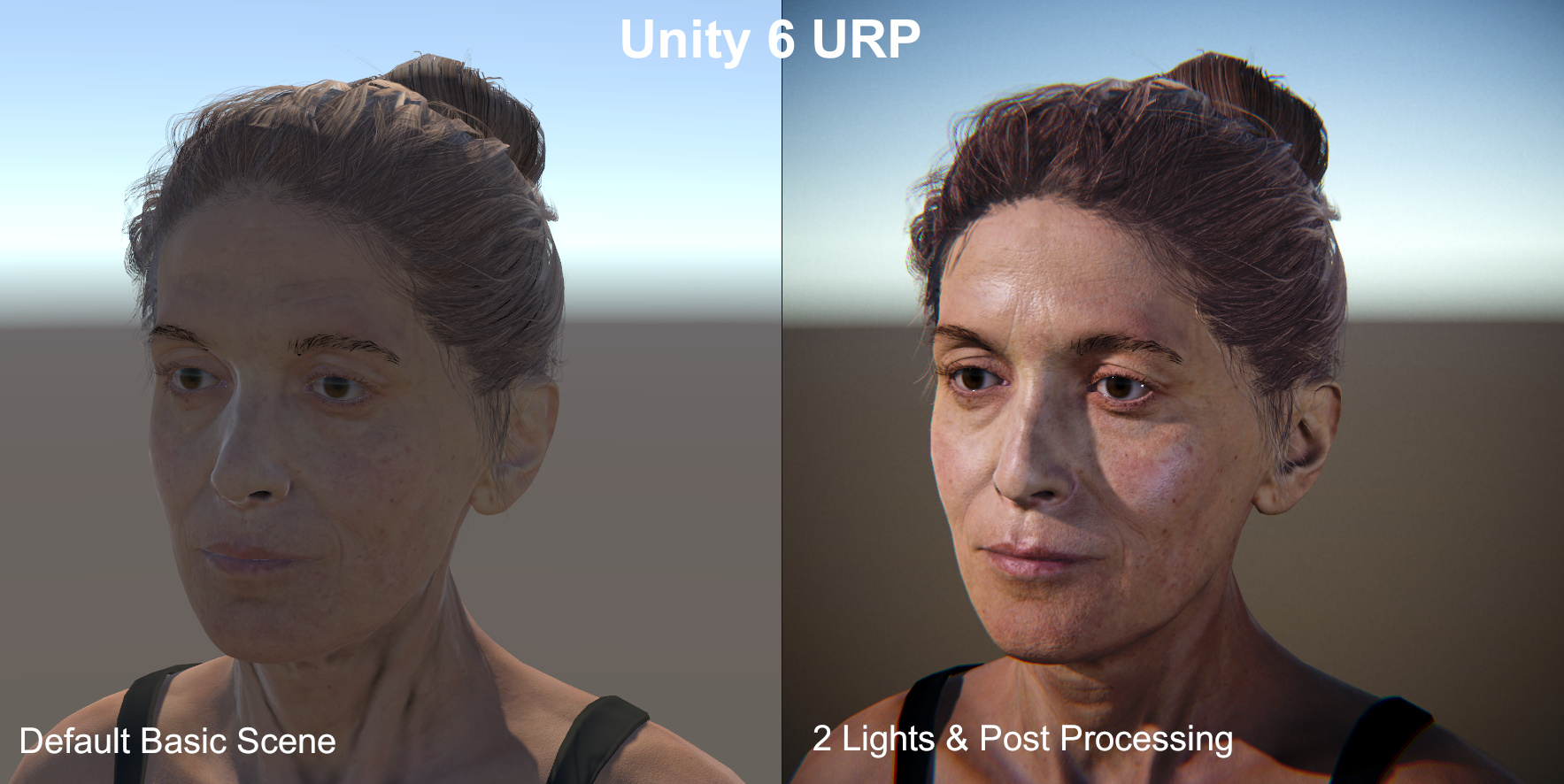

Lighting and post-processing is everything. The raw colour output of Unity (or any other rendering engine for that matter) is not great and needs to be adjusted with post processing to get the look you want. The default lighting arrangement in a Unity scene is also pretty bad and makes it all look even worse.
e.g.
To remove the mesh poke through, you need to export the character with delete hidden faces checked.
Gotcha thank you so much. I honestly thought there was a lot more going on than just a post-processor so I appreciate you clearing that up.

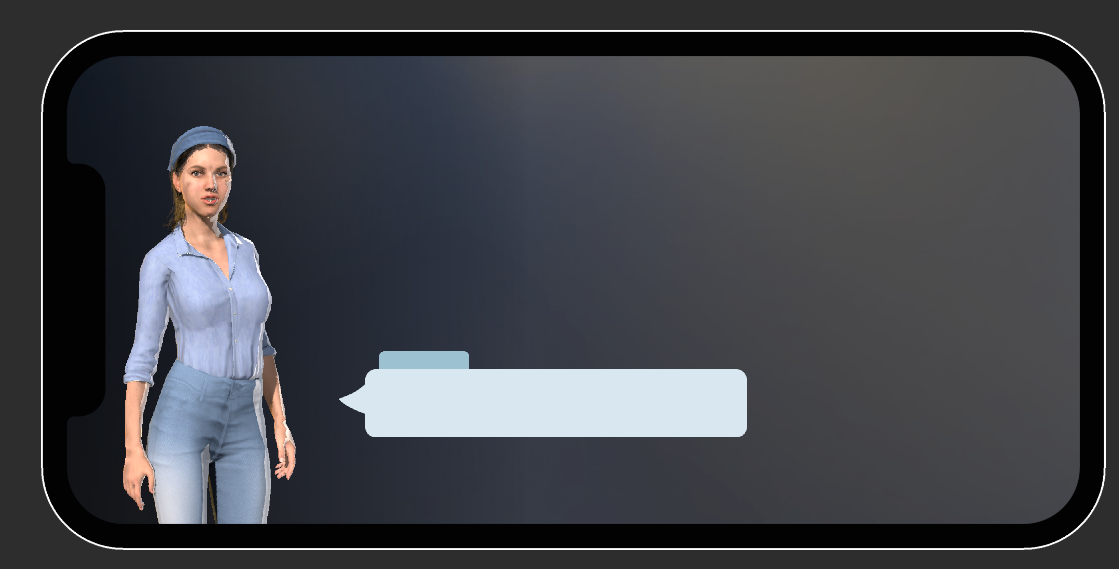

I solve very optimize character (Game Character, InstaLOD ~ 20-30 000 triangles., Merge Material UV all to one). For mobile game. How is possible to have this hairs look? Do you use CC4 shaders?

here is my character

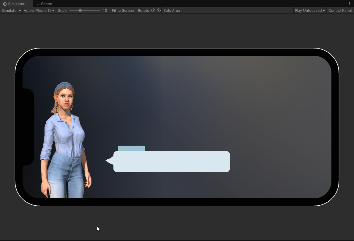

thank you for good points. yes - lite hair its the one of the options, but I still try to better the hair.
I try to switch shader/material from Opaque to Transparent and used Blend texture for hair, whitch makes hair shadowly on the backside, behind the neck
what do you think?
