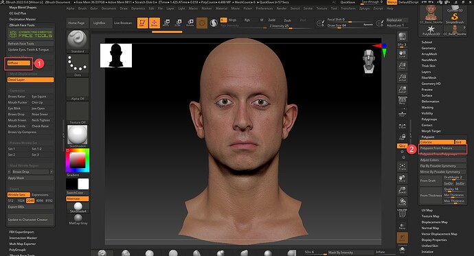

Hello, I had a question about the Texture in Wrinkle “Diffues” turns white. Would anyone like to help me? I really need your help.
I made a Wrinkle in ZBrush 2024.0.4. When I exported to cc4 using the plugin, I activated “Wrinkle>Diffuse”. Then my “Diffues” Texture became white like this. And the Roughness texture disappeared.
I want to know how to correct this problem Thanks for your answer.
Diffuse map baked from polypaint, please make sure the diffuse map is baked to polypaint.
