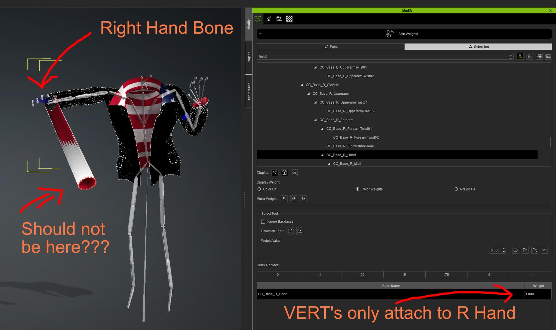

When I weight paint to the Left Hand (weight 1) the results are wrong. Its like the character is in an A-Pose. When I do the same thing with the Right Hand everything is fine. Also, the mirror results from right to left seem in correct. Again, this is the only bone linked to these VERTS.

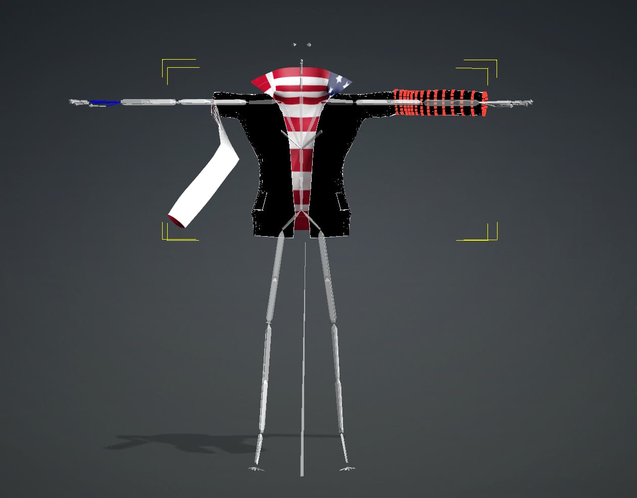

Thanks… I can almost replicate the issue, but it seem to be a bit intermittent. Also, it might only be happening on the ultrawide. Basically:
a) go to skin weights
b) select the layer (jacket)
c) select the right hand bone
d) select vert mode
e) select the vertices at the end of the sleeve (char right side)
f) select change to t-pose
g) select wight of 1
Sometimes its wrong here. Oddly, if you select a weight 0 its also in the same spot. so they seems to be some kind of bug, but at least I can avoid it now. I’ll create a video if it because perfectly replicable…
