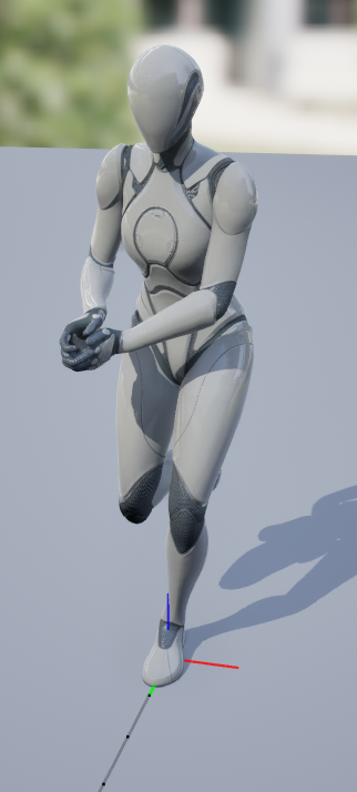

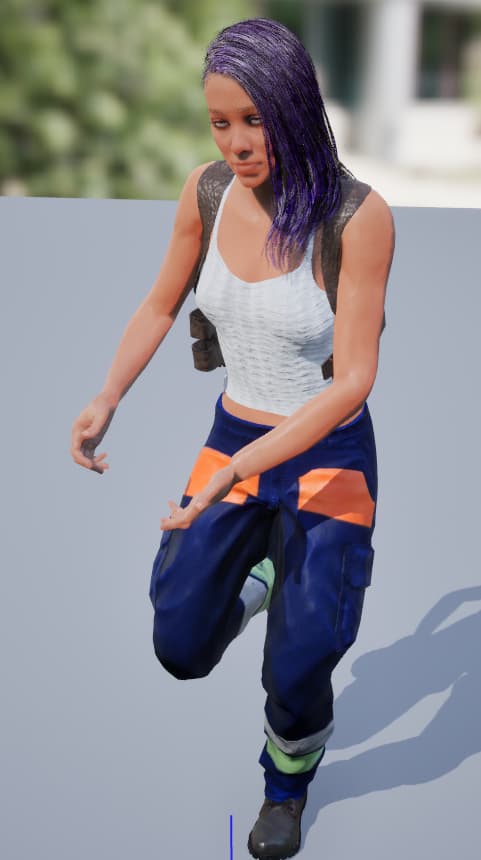

CC4 skeleton in Unreal seems to have some issues after import, arms/legs have wide gait issues.
Still haven’t figured out how to correct this if anyone knows.

I’m importing the characters into unreal engine and applying a retargeted animation to them. The only work around currently is to adjust positioning of the legs and arms after the characters have been imported. This happens with every character imported, I’ve tried adjusting import settings and making sure the exported skeleton base pose is correctly set to A-pose for UE.
For animations created in iclone they work fine. For any animations that have been retargeted I have this issue.

I’m not retargeting animations in iClone, I’m retargeting animations in UE. If I export an animation I made in iClone it works fine, but if I use an animation from UE retargeted to the CC4 character, for example the basic walking animations provided in the 3rd person character template for UE, they have these wide gait issues.
I can work around this by adjusting the animations/skeletons inside UE so it’s not a gamebreaking issue.
