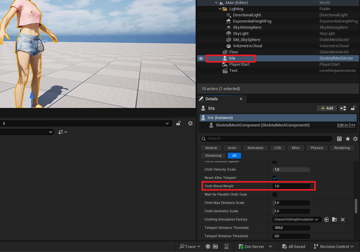

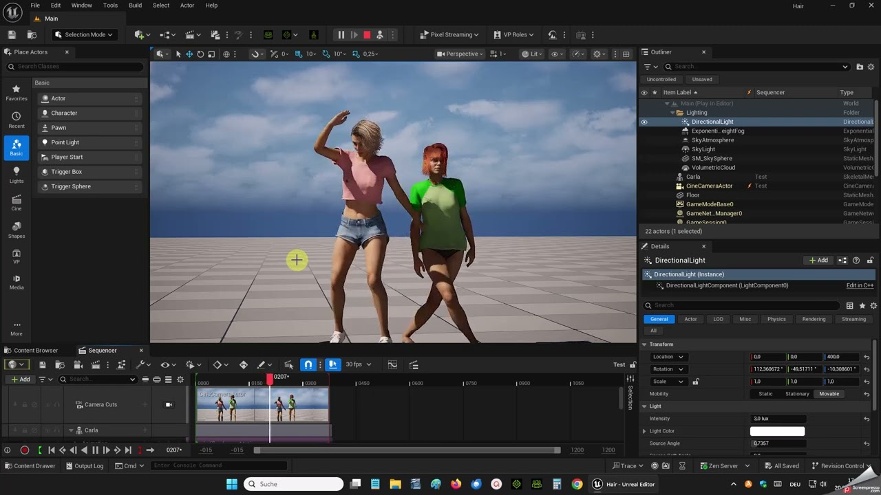

I haven’t done much with UE for a while, but I tried it and it works.
If you click on Simulate, you can see an animation of the hair.
However, UE 5.61
A little further down, you can also change the Cloth Blend Weight. See photos.
Regards, Robert

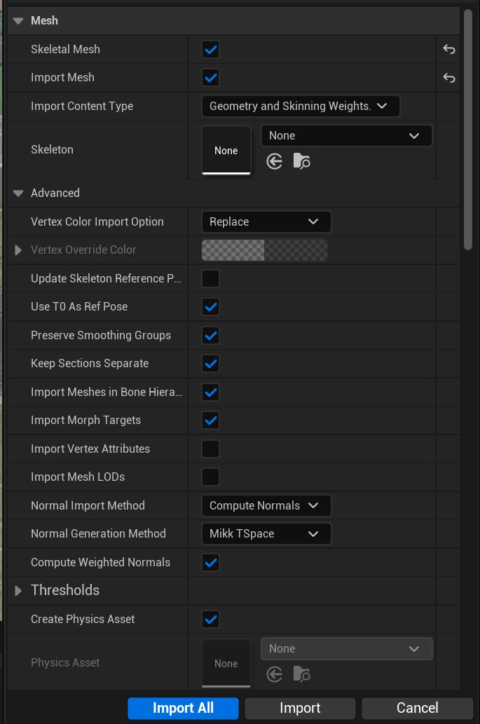

Hey, thanks for your reply, I really appreciate you taking the time.
I actually already had those options selected, but the good news is that I’ve finally worked out the solution: my import options were wrong. Specifically, I had the Vertex Color Import Option set to Ignore instead of Replace.
These are the import settings that worked for me:
