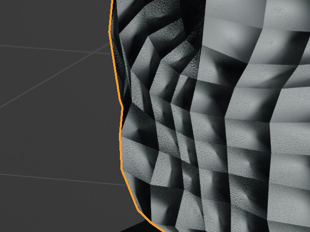

So, I wanted to correct meshes normals with Go-B as I’m not sure why but shading started to get weird in CC4.
When on Go-B and setting flat shading this is what I get.

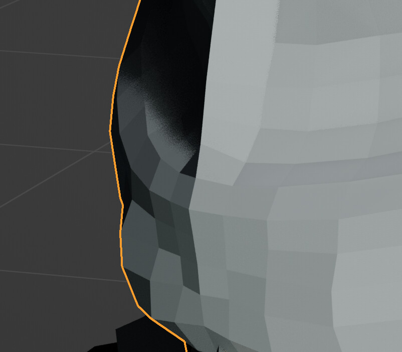

When I clean cutom normal split it get back to normal :
But when pressing “Mesh” or “Material” in CC link, normals are not corrected, and UVs are not sent either in CC4. I can move vertices around and they can get updated.
