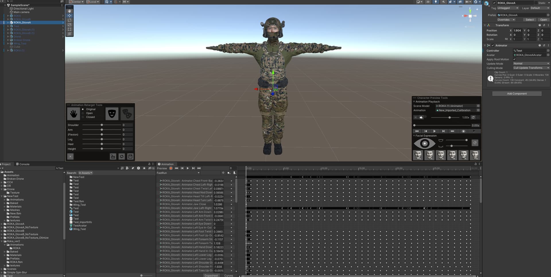

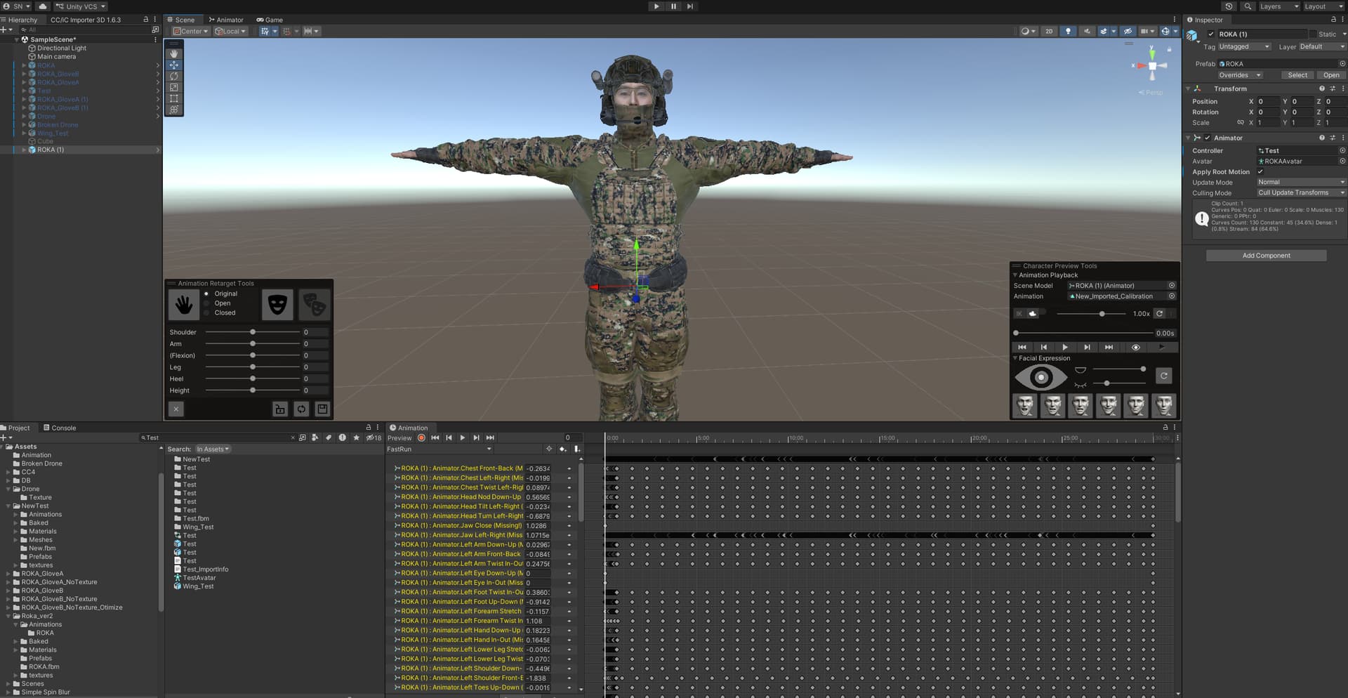

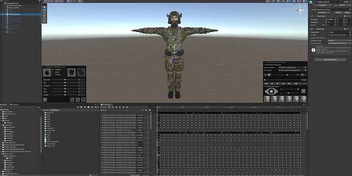

When I apply the same animation to both characters in Unity, the ROKA(1) character shows an “Animation Missing” error, while the animation works correctly on the other character.
Please check the attached image.

Check your model import settings on the ROKA (1) character FBX, it looks like it’s not set to humanoid.
The yellow text on the animator tracks, in the first image, means the animation paths don’t match with the model.
