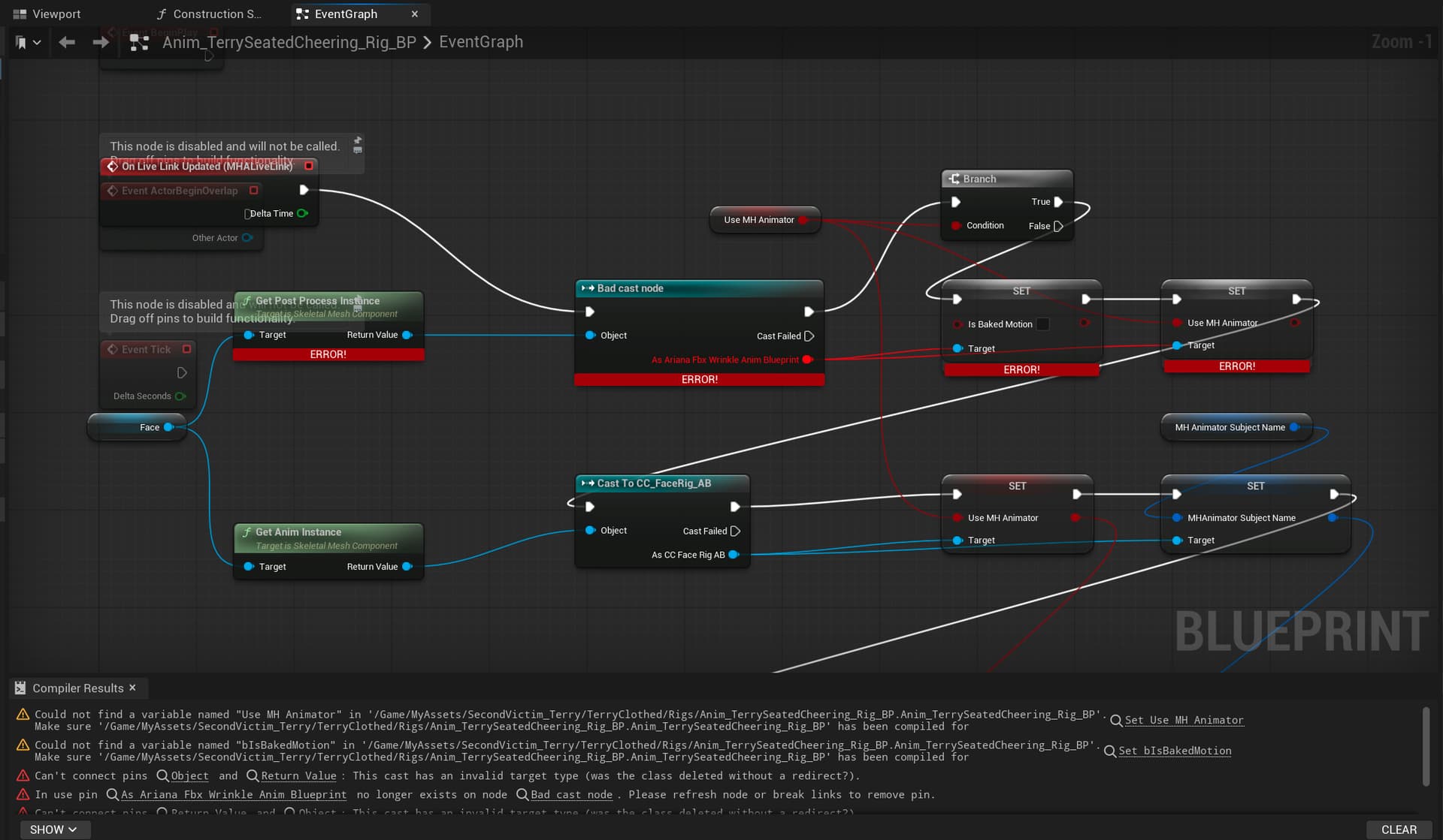

So, I exported said character via FBX into UE and chose the HQ shader option; I then create a CC rig by right clicking the skeletal mesh → Create CC rig option; I then try to test and get a blueprint compile error in [MyCharName_Rig_BP; I’ve attached the screenshot
Hello, I’m having the same issues, working with CC4 and UE 5.6 Control Rig. No sure how to fixed it.
