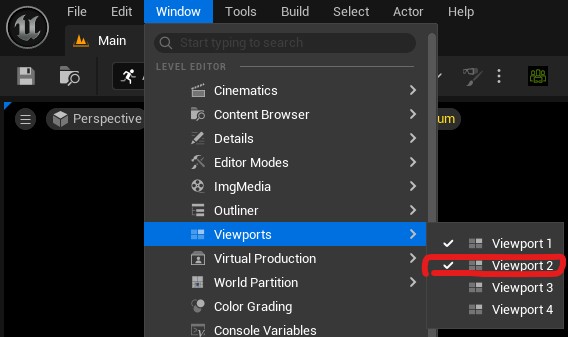

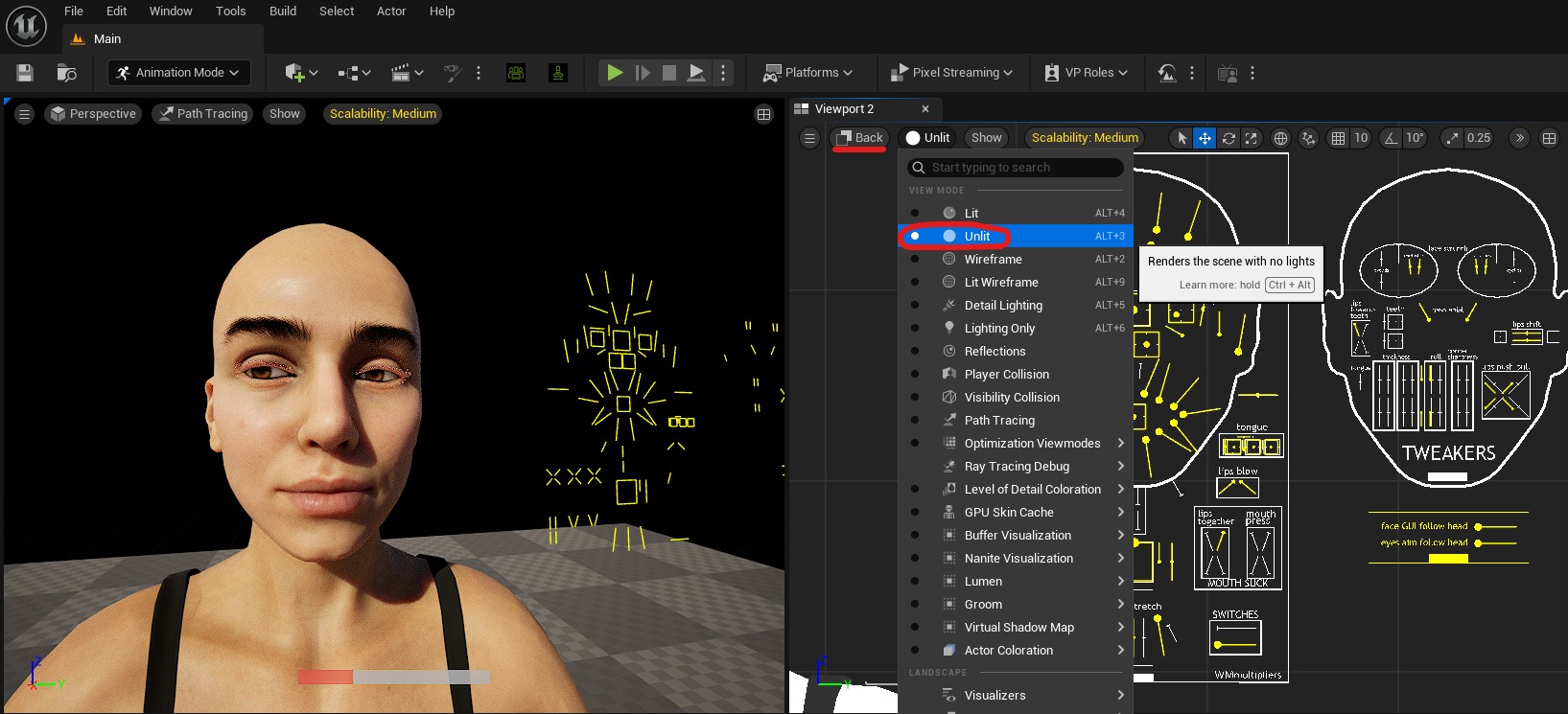

Regarding CC Control Rig, you can enable Viewport 2 to solve the issue where Path Tracer cannot display the CC Control Rig. Please refer to the screenshot for details.
Amazing! Thank you!
