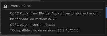

I really like the datalink option, but it’s not working anymore
I get this error, so I tried to install the older versions again, but nothing happens.
And when I try to start the reallusion hub nothing happens. So now I’m stuck. What can I do?
Hi…
If the Hub is not working, please try uninstalling it by going to Start > Settings > Apps > Installed Apps. Once uninstalled, download and install the latest version from HERE. This should then allow you to update all your tools.
I’ve encountered this exact problem yesterday. And I think it has to do with the updated CC/iC Blender plugin. (v.2.3.0)
So I restored the plugin to version v2.2.5 (Blender > Preferences > Add-ons > CC/iC Tools > Updater settings) and Datalink was working correctly again.
I guess RL need to update the Datalink plugin to work with v.2.3.0.
