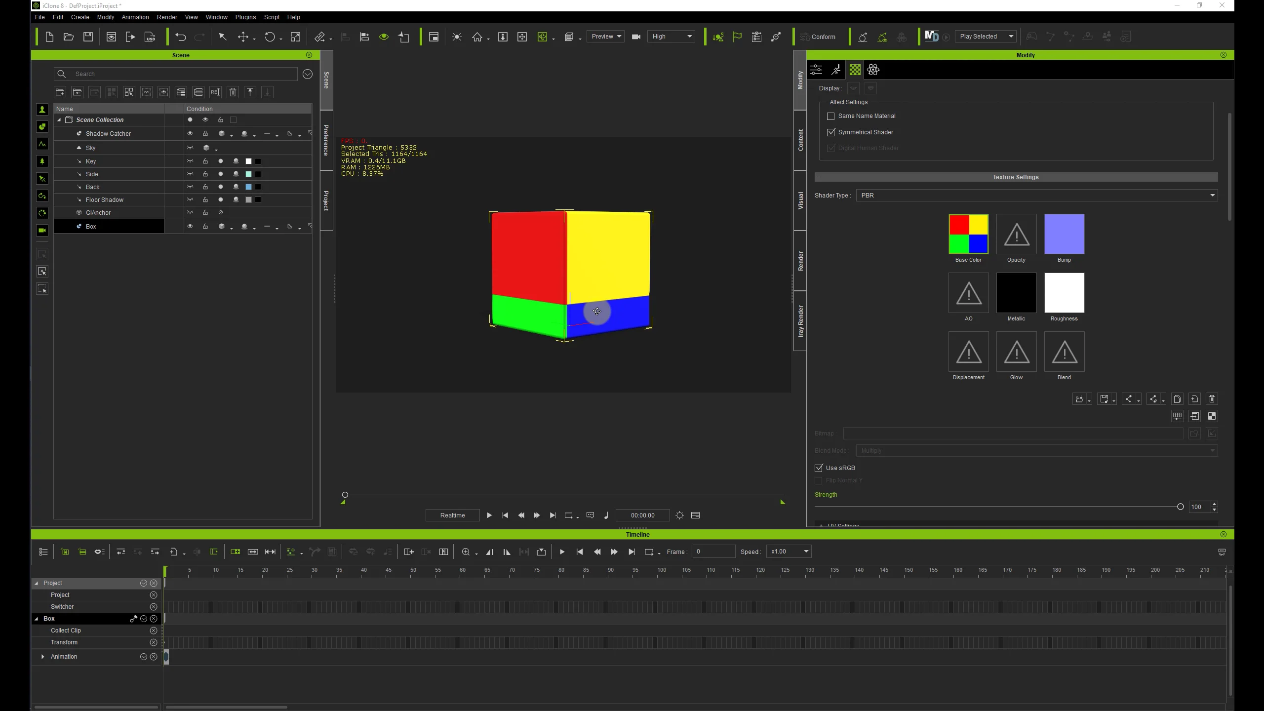

There is no “easy” GUI interface to animate sprites, but it can be simulated with UV tiling and offset.
In your case you set a static Tiling as U=0.5 and V=0.25 for the Base Color image. I suppose there is a separate material for eyes (if there is a separate material for each eye, then you have to divide U further).
And then animate at the timeline with UV offset. Each key got to have a “Step” type Transition Curve preset.
A quick video a made for someone who asked similar question a couple of years back.
