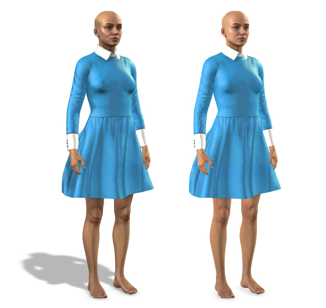

Thank you @animagic . I’ve tried this and it’s still casting shadows on the character. Its throwing some really harsh shadows on the character’s face and body. See picture attached with a side by side with (left) and without (right) shadow casters. I’m not sure if I 've missed something.
It’s casting shadows the same way a regular light source would. Any idea what else I can try? Thanks again!!!

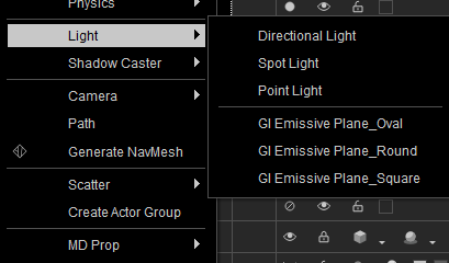

i didn’t see a blacklight in 8. Id love to try this method.
all i see is what the screenshot is showing. Lmk is I should look in another place. Id be very curios t try this method too.
Screenshot_209
you pull up any light but use a color black for the light color.
