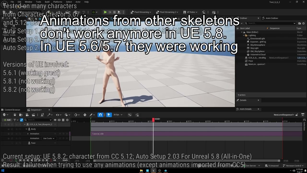

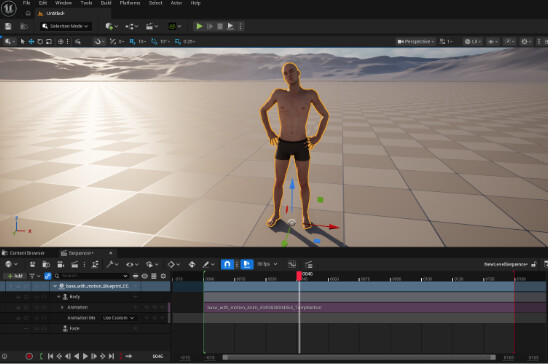

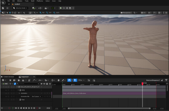

Symptoms / The Bug: When applying any external animation to a CC5 character in UE 5.8, the skeleton breaks completely:
  • Bones become severely twisted and contorted.
  • Limbs detach or fly off to the sides.
  • The character mesh remains entirely static and doesn’t move, except for a single finger.
What DOES work:
  • Facial Animation: Works perfectly as before (e.g., using the MetaHuman video-to-animation pipeline).
  • CC5 HD Body Rig: Functions correctly, and the bones rotate properly within the rig itself.
The core issue is strictly tied to the body skeleton failing to retarget or play third-party animations.

    • UE 5.6.1 — Working great (same setup/pipeline works perfectly here).
    • UE 5.8.1 — Not working.
    • UE 5.8.2 — Not working.
Current specific setup where the video was recorded: UE 5.8.2; character from CC 5.12; Auto Setup 2.03 for Unreal 5.8 (All-in-One). Result: Complete failure when trying to use any animations (except animations imported directly from CC5).
