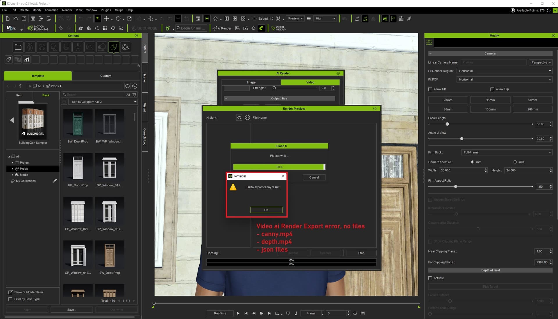

I have encountered a critical bug when trying to render videos using the AI Render plugin in iClone 8.7. The plugin fails to export specific ControlNet video files and completely stops the ComfyUI workflow.

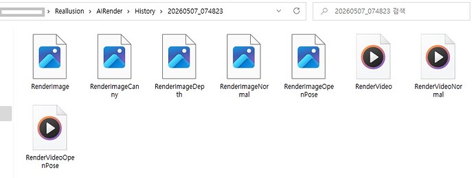

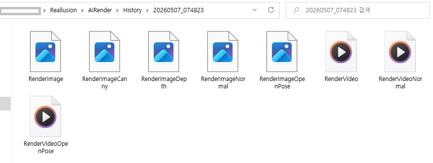

When I select a Video Style and click ‘Preview’’ in the Video tab, the process halts, and a pop-up warning appears: “Fail to export canny result” (Please see Attached “airender error.jpg”).
When I check the AI Render History folder (Please see Attached “airender error02.jpg”), the issue becomes clear:
1] Missing ControlNet Videos: It successfully exports RenderVideo.mp4, RenderVideoNormal.mp4, and RenderVideoOpenPose.mp4. However, it completely fails to generate RenderVideoCanny.mp4 and RenderVideoDepth.mp4. Interestingly, the single image versions (RenderImageCanny, RenderImageDepth) are generated without any problem.
2] Missing JSON: Because the export process crashes at the Canny/Depth video generation stage, the essential .json workflow file is never created in the folder. (i checked “edge” in control net tabs, but no files result)
3] ComfyUI Disconnection: Without the .json file and the missing mp4 files, the task is never sent to ComfyUI, leaving the pipeline completely broken.
[Steps to Reproduce]
  1. Open iClone 8.7 with the AI Render plugin (Oct 2 version).
  2. Set up any scene.
  3. In AI Render, go to the Video tab. Check all Control Net options (Edge, Depth, Pose, Normal).
  4. Click ‘Preview’.
  5. The “Fail to export canny result” error will pop up, and the output folder will be missing the Canny/Depth videos and the JSON file.
This seems to be a specific video encoding/export bug between iClone 8.7.1 and this version of the AI Render plugin. Has anyone else experienced this, or is there a hotfix available?
