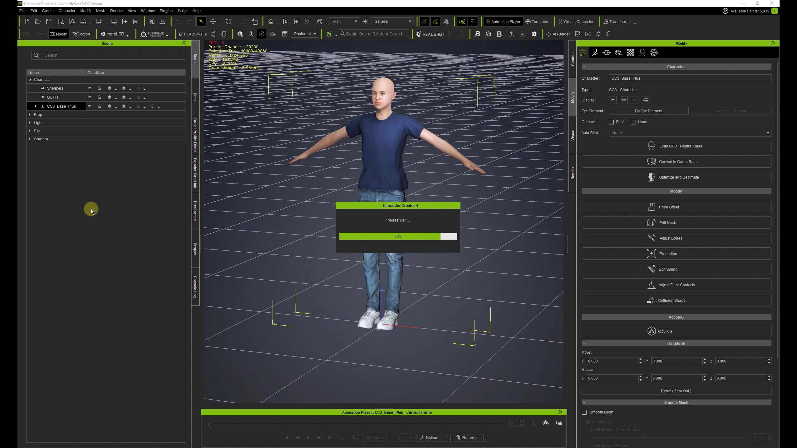

Yes, as long as morph does not involve bones scaling (or at least bones scaling is minimal).
I came up with this routine some time ago which only involves CC and Blender (no iClone needed)

BTW, I forgot to ask if you have an iClone. Because the method above is good if you only have Character Creator.
Having iClone, makes the routine a lot easier by creating animatable morphs directly in Morphs Creator.
There are probably a few comprehensive tutorials on the subject available to search for.
This one is very basic and quick.

Yes, I do have iclone! I just did this and it works perfect! I didn’t even know the morph creator and animator was a thing, so I was probably using the wrong keywords to search. Thank you so much!
